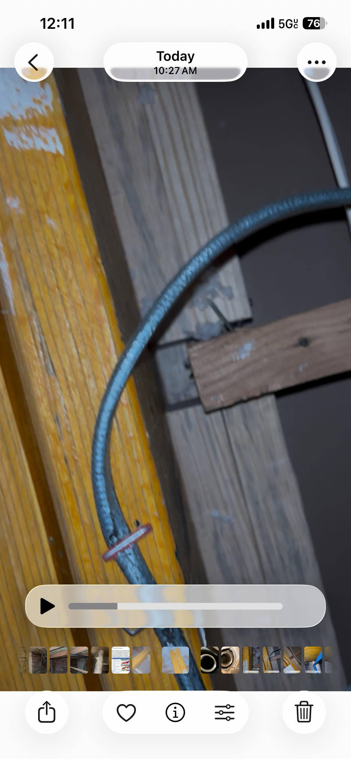

Im new to the inspection world. This doesn’t seem right to me. I’ve been a general handyman for 25 years so maybe I’m wrong but those gaps seem to be a safety concern. The pictures show a double LVL in the attic with ceiling joists “tied” into the sides. Fail? I’m definitely going to note it in my report but what level of concern should that be?
Thanks for any advice!
Undersized hanger and the joist is not seated.

it is wrong, full bearing requires 1 1/2”. i would note it, probably recommend a qualified licensed professional to evaluate it and their recommendations followed.
It is wrong, I noted a couple of reasons why above. And because it is an LVL combined with significant load-bearing modifications to the home, I would recommend a structural engineer to evaluate and prescribe repairs to be performed by a qualified contractor.

Ceiling joists are designed for 10 pounds/SqFt (psf) dead load plus 10 psf live load. Floor joists have 10 psf dead loading plus 40 psf live loading. Big difference in the load held by those hangers. If those ceiling joists are spanning 20’, each joist hanger is supporting only 320 pounds.

The hanger is too small and the gap exceeds manufacture’s recommendations. If that is a ceiling joist on a stick built gable roof then tension is not what joists hangers are designed for. That should have a metal strap attached to the bottom connected to the joist on the other side or to the LVL

IMO, there should be a strap on every joist, and a fastener in every hole!

According to the homeowner the LVL was installed a month ago when the wall beneath it (20’ long) was removed to open the space between the living room and dining room.
Functional… the ceiling is still where it’s supposed to be. :blush: Recommending a GC or structural engineer to evaluate and recommend next steps because I’m not sure it will stay there.
No reinforcements were added to hold up the LVL either. The ends are resting on pre-existing 2x4 walls with no studs directly beneath on either end. The nearest vertical studs in the walls are 4” and 7.5” respectively.
“…was installed one month ago…” Good decision. It doesn’t pass the functional test and becomes sloppy work. The missing studs directly under the LVL bearing points are called “support posts” or “support structure”.
