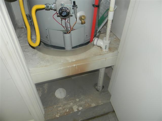

Someone recently asked about a attic downflow did not have a easy pic of one but had this upflow today and I liked they way it was installed except I don’t like flex duct of any kind. The furnace install was almost perfect except no trap or cleanout in the drain line but I like where the drain terminated at the water heater they even installed a safety pan on the water heater and it was in the garage shock shock. Now the exterior condenser my youngest grandson could have done a better job. Suction line was excessively crimped and the liquid line dryer/filter undersized for a 4 ton unit
