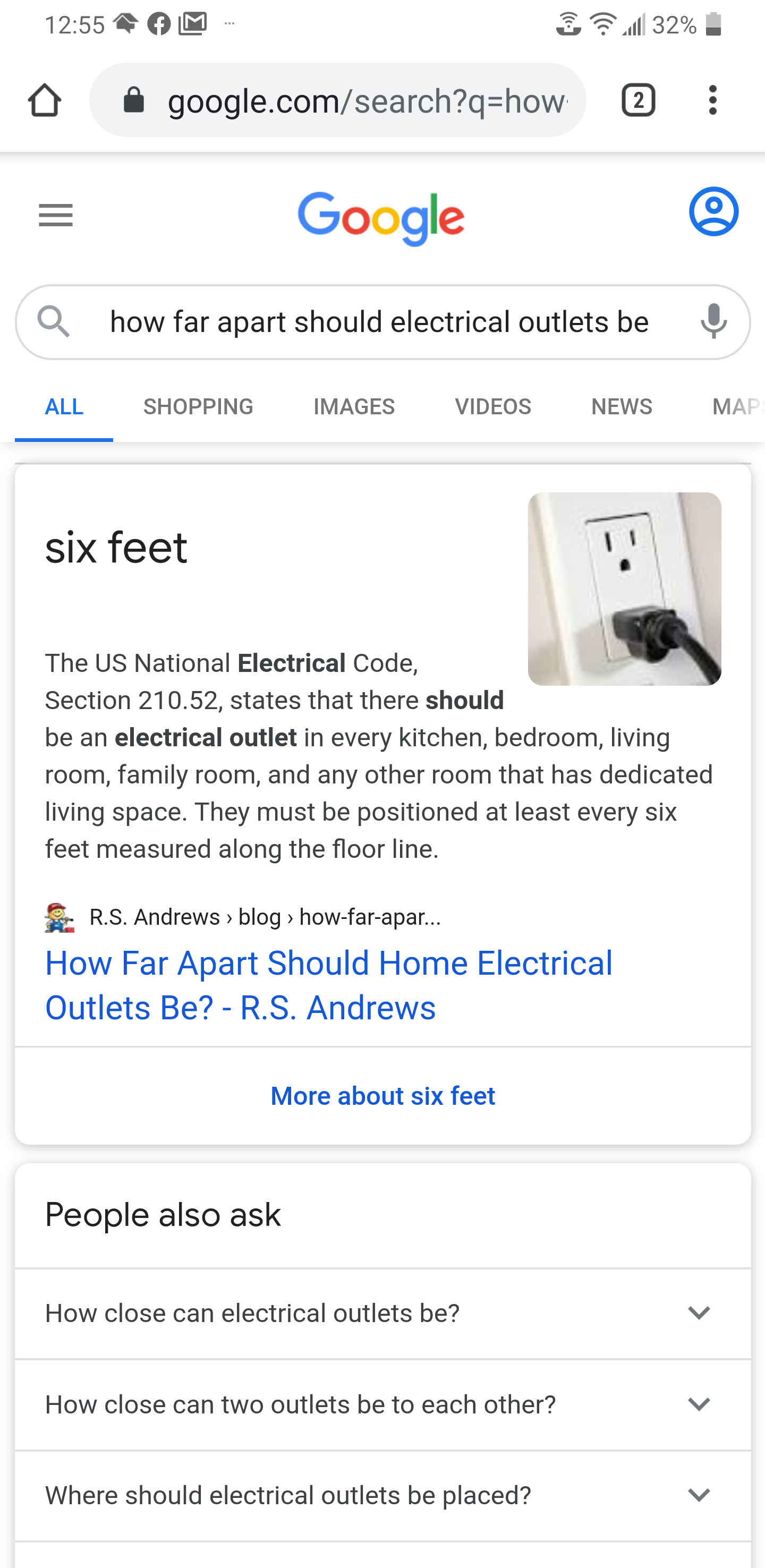

Here’s what a Google search came up with:
The US National Electrical Code, Section 210.52, states that there should be an electrical outlet in every kitchen, bedroom, living room, family room, and any other room that has dedicated living space. They must be positioned at least every twelve feet measured along the floor line .
How Far Apart Should Home Electrical Outlets Be? - RS …
https://www.rsandrews.com › how-far-apart-should-home…
(https://www.rsandrews.com/how-far-apart-should-home-electrical-outlets-be/)
Oh, look- they corrected their misinformation. Not really surprised. That was 18 months ago, in August of 2020. And I’m sure I wasn’t the only one who caught it.
