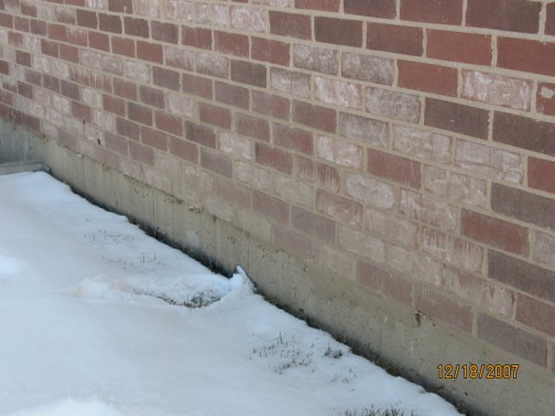

All the window trim cladding is lapped wrong on this home. What says you?

No this is aluminum window trim cladding that is installed wrong.
You’d think, for $900,000, they could find a way to conceal the J-molding, too.

I just noticed the j-channel is also wrong.
They’ve been here during the warmer weather. Weep holes? What’s that? Oh OK, si habla we can do that. Just scrape out the mortar here and there. OK my friend??

What are weep holes?
Mark, looks like another job done by ACME Hackem.
This is common when a builder pays cheap peice work wages and only the inexperienced will do their work. Good call.

That type of flashing installation is a common occurence in one city in my area.
Here’s a nice one for your viewing…I want to know what the installers were thinking with this install…
don’t worry the water will eventually make it out.:shock:
