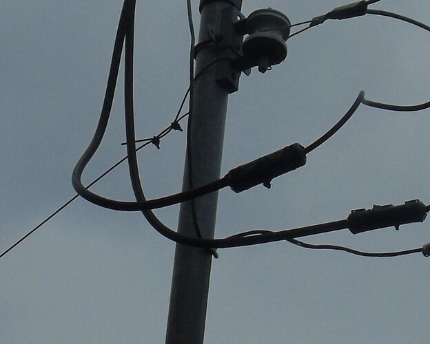

Bare SEC neutral contacts mast.
Looking for narratives. Any help would be appreciated.
 ![Mast-Neutral](https://global.discourse-cdn.com/internachi/original/4X/a/2/f/a2f2bd2e4a089b9c7414e598ec274eb356f0d178.jpeg)

Report what you see and, if you believe it needs to be referred out to a qualified electrician, do that.

Are you asking **how** you should report it or **if** you should report it?

The metal mast should be bonded to the neutral.

There’s nothing that needs to be said. If you are going to say something, I suggest “It’s OK”.

I concur, George. Nothing said.
