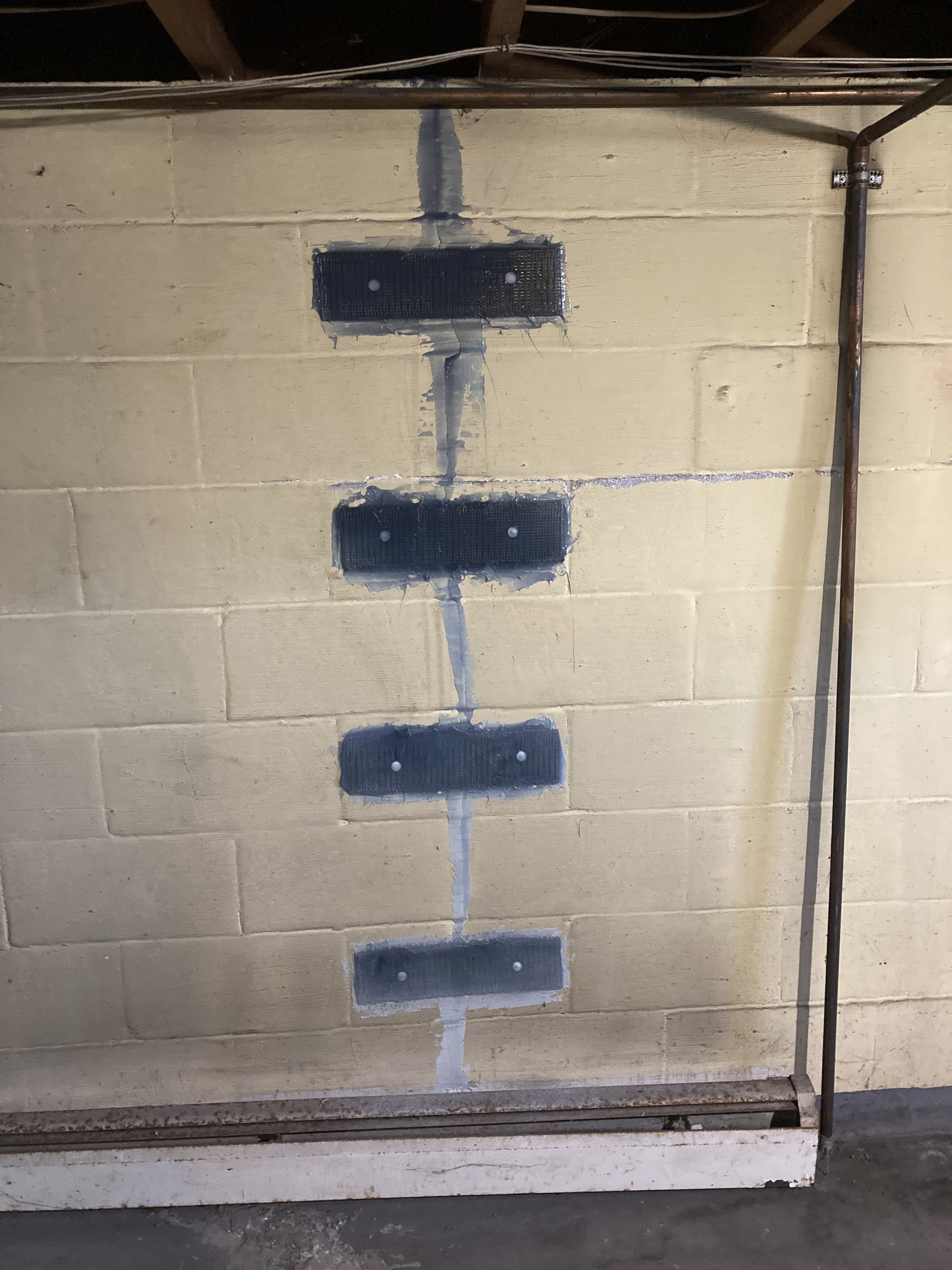

Hey fam!
Anyone know what this is?
Looks like a foundation repair…
I am with David on this.
CMU foundation. Vertical foundation crack with steel or carbon fiber retention straps.
The real question should be…
What was the contributing factors that caused the damage, and were those factors corrected?
Like many other “methods” we see, what is shown in your photo is simply a “bandaid”, not a fix!
Did you observe any related conditions?
Were the wall(s) bowed? True plumb? Other?
It may look “stable”, but could simply be a ‘Red Flag’ of more to come!!
How did you comment/report on the situation?
From my perch here in Ohio, that looks like a really bad foundation repair that has already failed.
Looks like a carbon fiber DIY kit was installed. Honestly, I see cracks like that weekly in my area. I have a very similar one in my own foundation that has been there for the entire 20+ years I have lived here and has never changed.
More important than the crack itself is how the walls looked, as Jonas described above.
Some have lifetime warranties, check with the property owner.
there was a lot of moisture Damage: wood rot, spots on my thermal, etc. The sloping of the vegetation outside isn’t doing it any justice and the downspouts are non functional, all most likely contributing to the problem, although I didn’t say anything in certainty. I just recommended a licensed Foundation Specialist Further evaluate.
Good call Will, I would have done the same.
