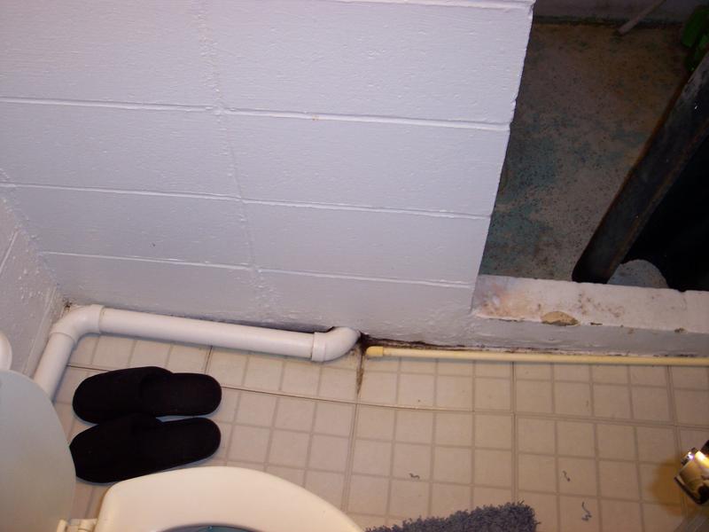

Okay, yesterdays inspection had some unusual situations. Here’s a taste, and looking for opinions…
1958 home w/basement. Basement was partially (3/4) finished. A bathroom sink was installed where the drain piping was run to the floor drain utilizing an air gap principal. It was not plumbed with a trap nor directly to a waste stack.
Although unconventional, and being as the sink only handles grey water, is there actually anything wrong with this setup?
Thanks in advance,
Jeff

Thanks for your input. The buyers were with me the whole inspection, and was pointed out, and discussed. I told them I wasn’t ‘positive’ if there was any violation in this set-up, but I would research and include my findings in my report.
If anyone knows of an actual code violation, please reference it, as this is an USDA inspection, and must meet their requirements.

Is that an A/C condensate drain on the other side?
Gee ,I hope I get to take a shower in that one.
Correct, Bob.
Notice neither one (piping) passed thru the wall, so the water/moisture runs througn the hole and is wetting the block.
are you sure that it is not just a floor drain goes into the storm drains, and the shower has been added? j
Since that is just CMU it may not matter which side the water is on.:slight_smile:
I did notice the 90 though.
Evidence points to the drain going to sewer. (No odors in shower, except mild mildew stain).
From the layout, except the sink, everything (appears) to be original to the home build. The shower stall (on right of block wall), the toilet (on left of block wall, sink (in question) other side of block wall behind sink is the original location of the laundry (has been relocated to a bedroom upstairs). No piping from under basement slab entering sump pit (only from exterior).

In the Ontario Building Code a lavatory must be directly connected to the plumbing system.

Its garbage, you can’t plumb that way, inform buyer. Its a serious code violation and trouble for buyer as it will have to be demo’d and re- done.
This a code violation, no air gap should exist between a lavatory and trap arm or stack or bypass stack to drain a sink, every fixture requires its own trap and utilizing the floor drains trap for a secondary drain is illegal, need to re read your basic plumbing & drain waste chapters, basic plumbing 101, recommend not using and call a plumber for estimate so the buyer can counter the proposal with a deduction in selling price for repairs.
