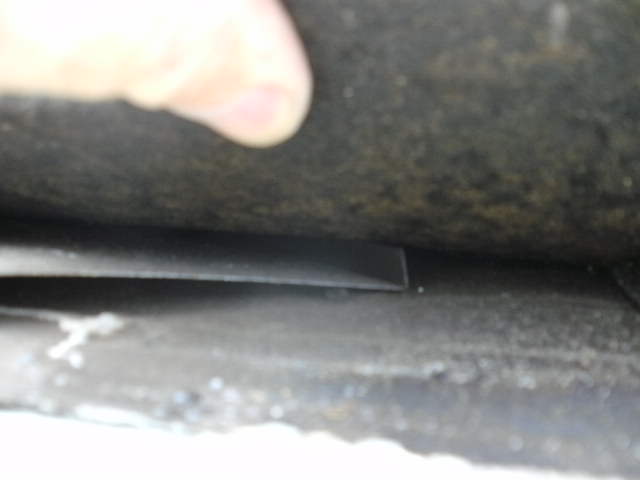

Saw this today on a 6 year old home. Doesn’t leak so its good to go.
www.MauiHomeInspections.com
Wow, it doesnt leak?
Sure, it’s not raining.
This home is on the windy/rainy side of the island and there is not a drop in the attic. Four valleys all the same.
Must have had wide valley flashings as well as tarpaper underlayment.
It does have a tarpaper under layment. The valley flashing is made for a tile roof with the up turned edge. I recommended a complete redo.
