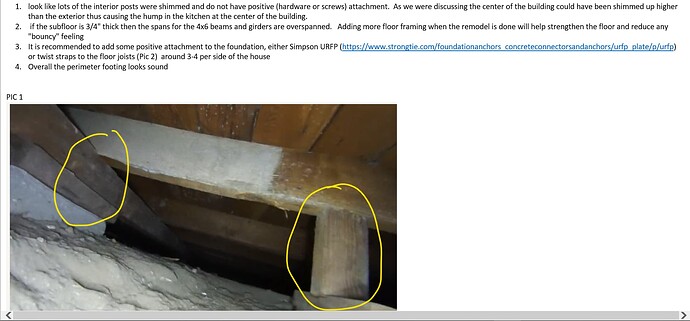

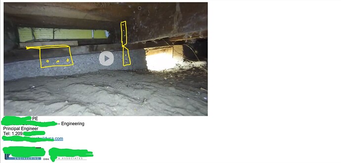

We were called in a couple of weeks ago to video record an 115 year farmhouse non accessible crawlspace with our BIGCrawler. This was done so an engineer could make recommendations on the structural improvements needed (severe settling from additions made) as well as how to access these areas, whether it’s by trenching or cutting up the beautiful original wood floors above. Really cool to see the media we provided in his emails detailing the suggestions.
