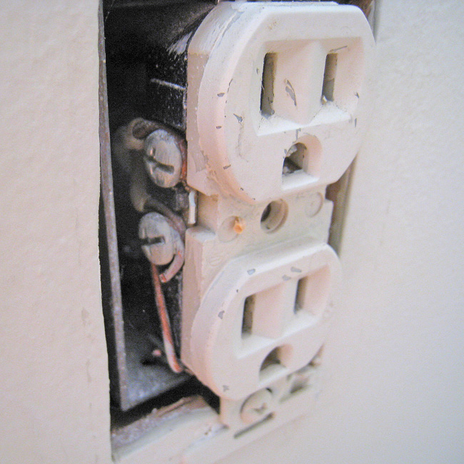

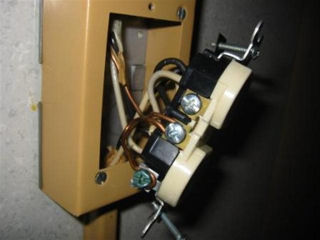

Here is a photo of a very neatly done (but very incorrect) bootleg ground.
Here’s another:

Is this one???
Is Buckwheat a Pseudocereal](Pseudocereal - Wikipedia)?
Yeah, but it is the ‘insulated’ version :slight_smile:
