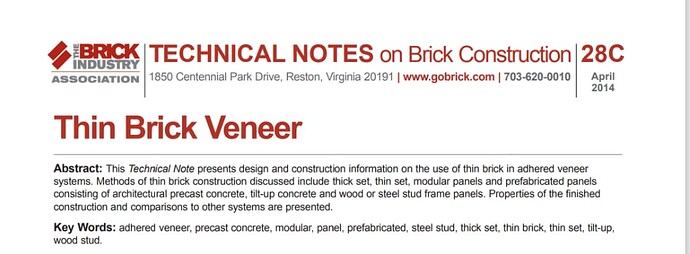

The .PDF posted is about adhered thin brick. This is different than conventional brick with a drain plain with corresponding weep holes, flashing etc.

R703.12.1 (1, 2 & 3) applies to adhered masonry veneer cladding systems, i.e., thin sections of brick or stone material that is adhered directly to sheathing surface and not conventional single wythe brick siding with drainage plane like I’m dealing with. But I appreciate you taking the time to respond.

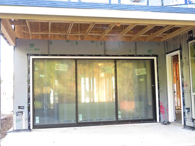

@rwelborn1 being as how folks are confused about what type of brick you are talking about and how it is installed, how about showing everyone some pictures

I have attached a picture from a recent pre-drywall displaying what it appears his question is about. Note the finished floor level and door thresholds are sitting above the patio/porch surface. This house will be bricked with brick running down to and resting on the patio surface with the required air gap between the brick and sheathing. Of course he would have to tell us if this is what he meant.

As I understand it, in Texas, monolithic SOG construction typically include both the interior AND exterior areas, including porches and patios, with raised ledges for brick. Some sort of membrane or flashing is tied to the wall and overhangs the raised ledge as in your photo
In many other parts of the country, the exterior flatwork is poured separately and the brick veneer either sets on a recessed brick ledge or something like steel angle iron that is bolted to the SOG. Then the exterior flatwork is poured with absolutely no regard for the brick weep holes or any weep screed. Keep in mind that our local climate dictates different mix designs for interior and exterior flatwork with an SOG situation, they are poured at different times in most cases.
