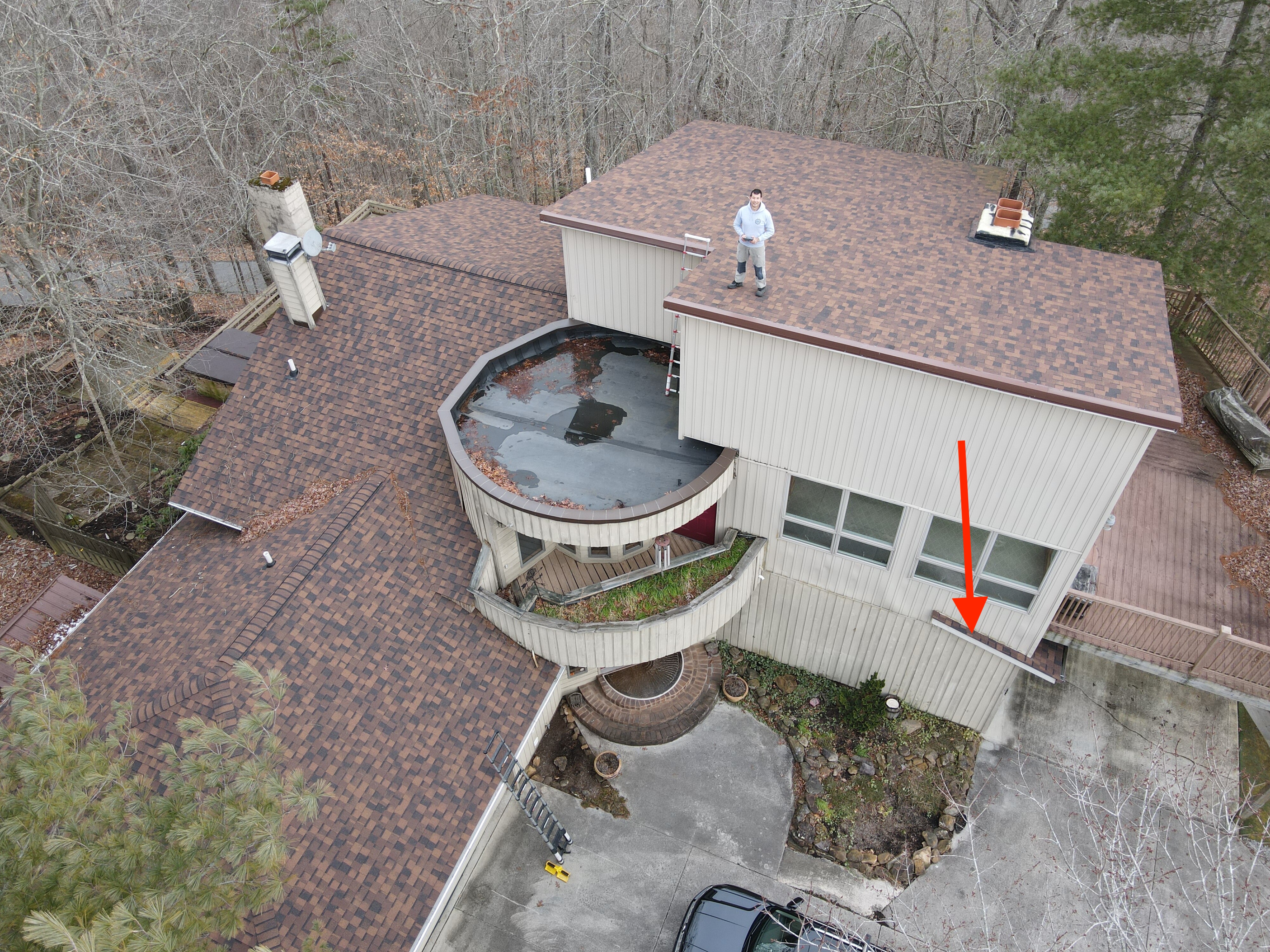

Nice eye, August. It sure was.
Nice picture, Bert!
And, what is this (gutter?) doing here, beside collecting leaves?
Some go rock climbing, Bert goes roof climbing.
The chimney on the right could’ve been a tad taller and without all the tar smeared around it :slight_smile:
Yes, I had a lot of things to say in my report about the roofs and chimneys in that report. I had a nice long discussion with they buyer yesterday (out of state buyer, did not attend)
Larry, the arrow you drew actually points to a small section of roof. Yes, it is unique. Lots of unique features and designs on that house :slight_smile:
Here is a better view of that goofy little roof under the front deck
Notice the putting green. There was a par 3 fairway and green on this property. The tee box is to my right, out of frame. It was a large estate on the top of a hill. If they fix the 80+ things in my report, it will be a nice place to live :slight_smile: Vacant for a few years.
It’s an overhang for windows below before the deck came in. Why they made it stick ouch few inches on the side is beyond me, silly in fact.

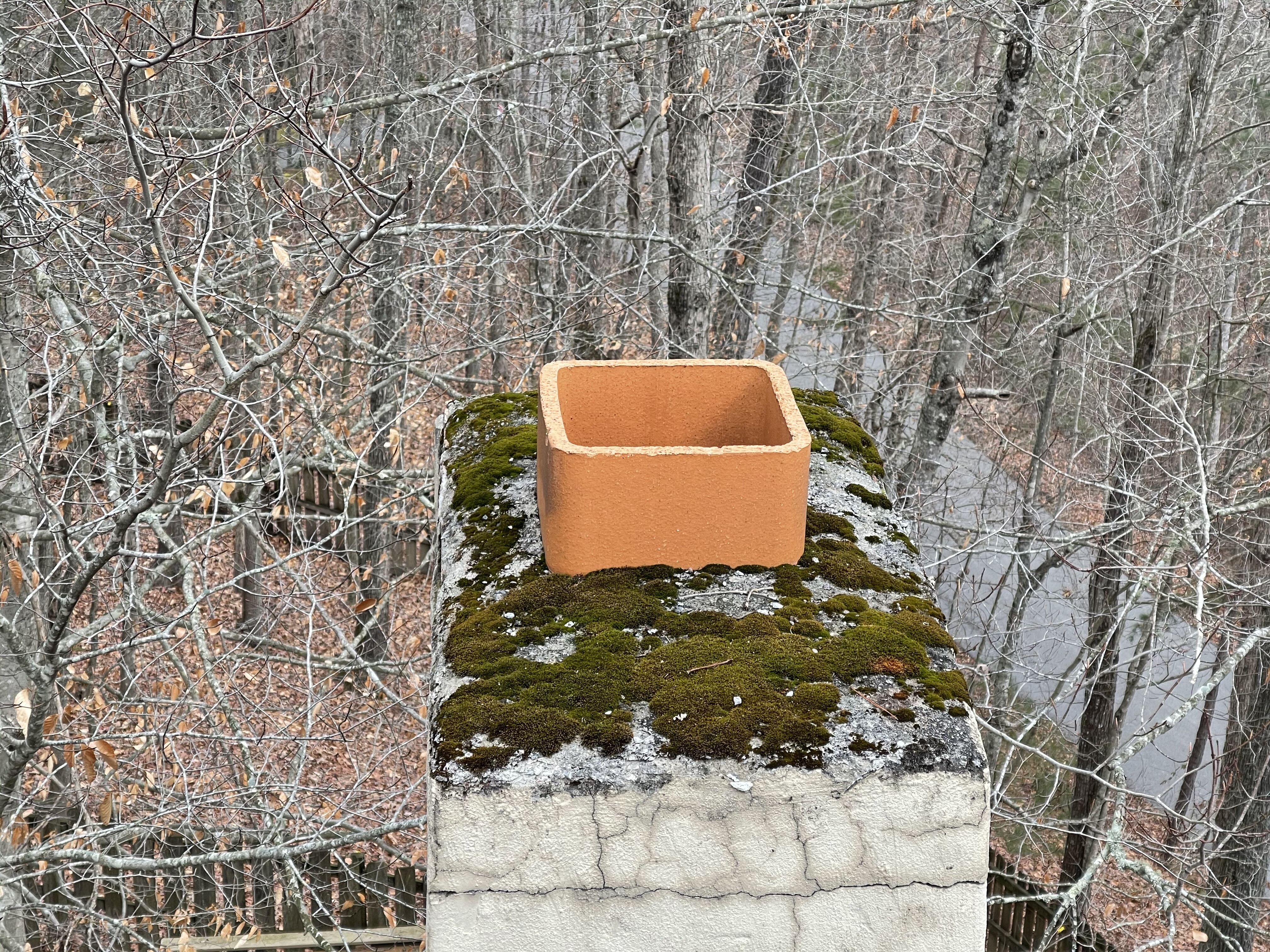

Yes, I called out a few things on that chimney. Cracks in the crown, no spark arrestors, rain was going down and had rusted the flue dampers so that they no longer could open and close, to short height over the roof, flashing had some issues.
My wife knows how I like to climb so she won’t let me inspect anywhere more than one story without a safety buddy. One way to keep track of me is to use the drone :slight_smile: None of the top roof was visible from the ground because it is on a hill top (downhill in all directions)
