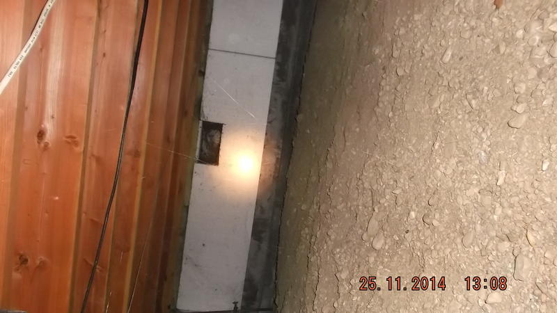

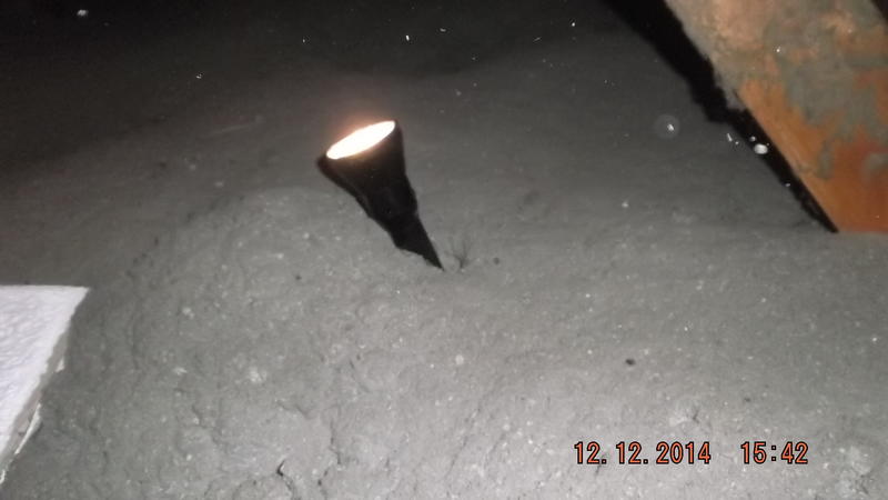

hello everybody, my first time on the message board as i need some Washington state credits, anyway, one way i casually measure insulation depth is stick my 13" flashlight in it and take a picture, just thought I’d share that little tid bit… yes i know we’re not required to measure but it just gives me a rough idea so i can verbally say, yes you have about xx "…
and the other pic is a lot of older homes here in n Idaho have only perimeter wall insul only, no under floor stuff, sorry, couldn’t figure out how to rotate it 90 degrees…
That’s a great idea … using the flashlight. First time I’ve heard of that tip.

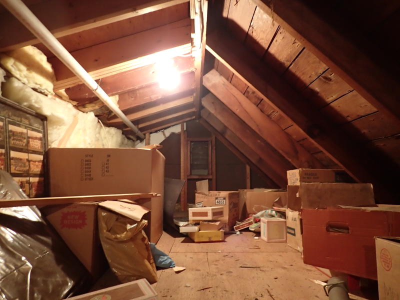

Hello All,
Here is a photo of insulated attic
Found:(Compressed) Insulation compressed, we recommend the insulation be “fluffed” or replaced as necessary to offer best efficiency. Some walked in the attic.
(Additional Insulation) Recommend additional insulation be installed, to bring it up to current industry standards.

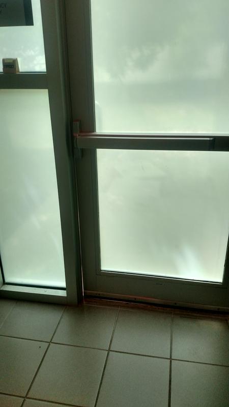

As you can see in the attached photo, the seal around this door is not functioning appropriately. Due to this, cooled or heated air from the HVAC system is leaking through the envelope. This will cause a rise in the energy consumption.

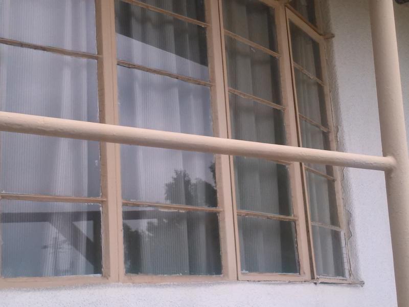

Just finished course. These picture are of a living room window that was in stalled when built. With windows fully closed and cranks locked, you can feel the air coming through the windows.
