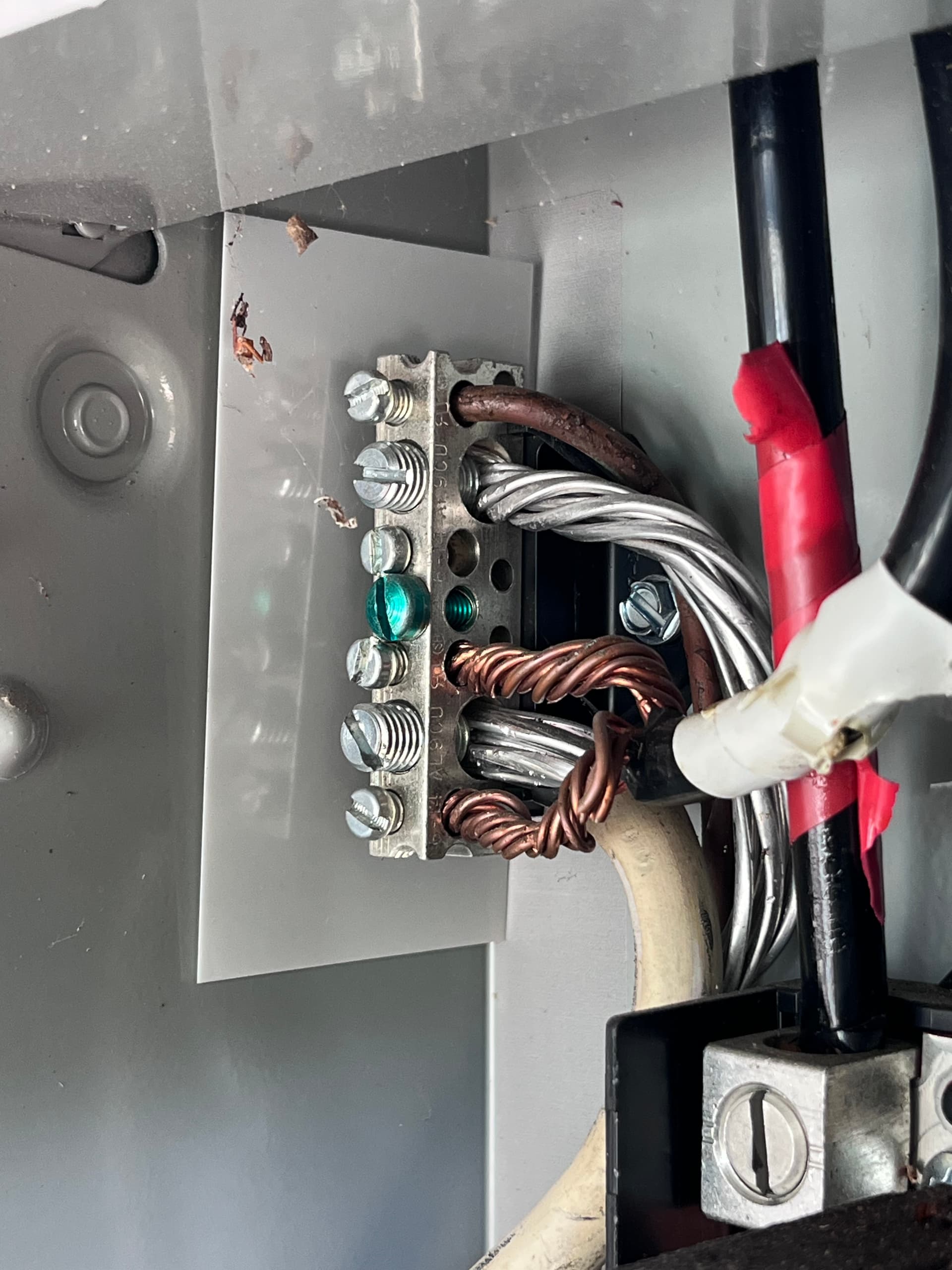

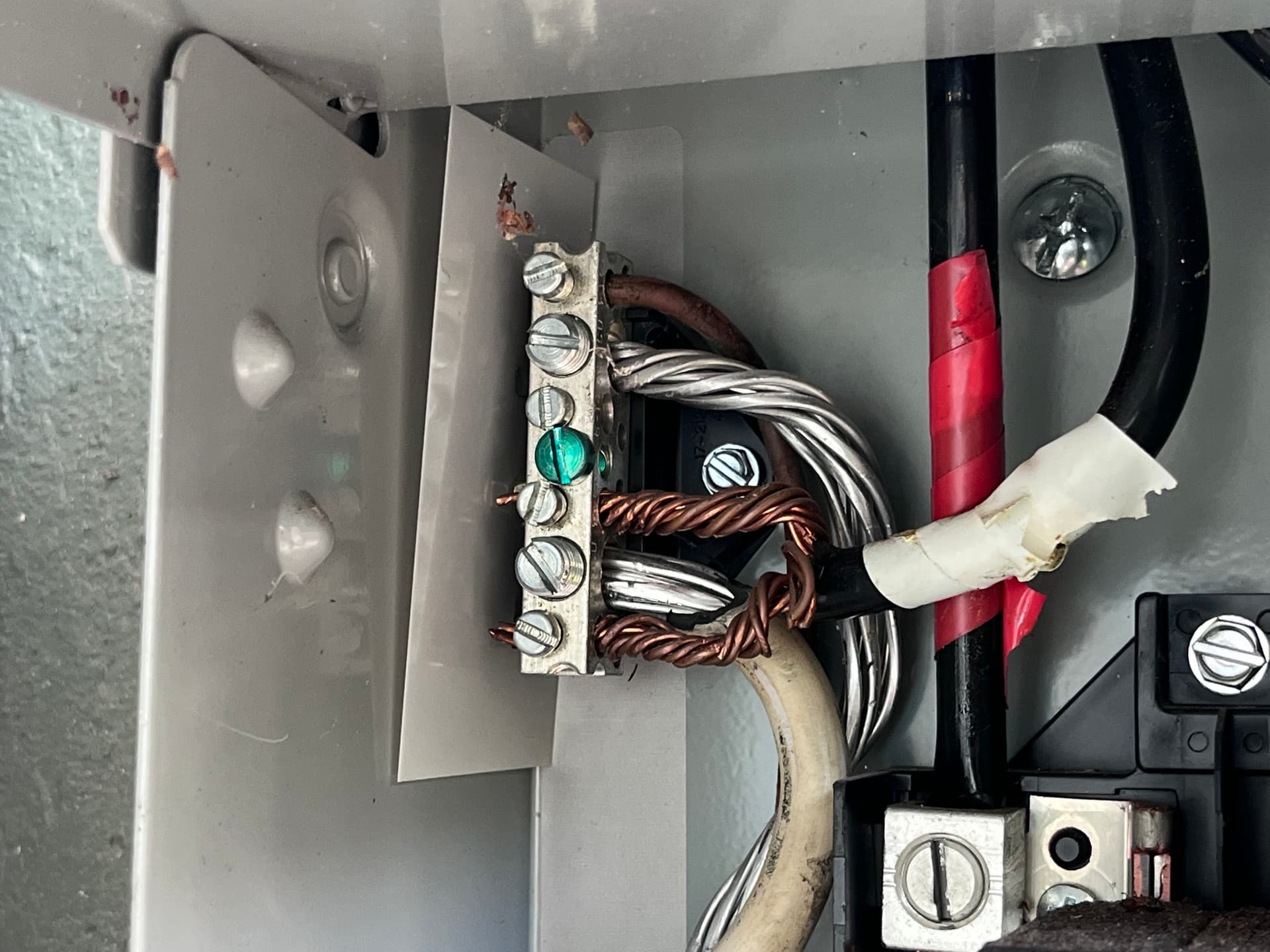

Can bond screws penetrate bus bar risers to contact the panel?
do those black plastic risers sometimes have holes in them for bond screws to penetrate and contact the panel? No because that would defeat the purpose of the riser, correct? just trying to confirm that this panel is missing bonding
The short answer is Yes they can, and Yes they do, when the bonding screw is installed in the correct location.
Isolators is the correct term, for the plastic “risers”.
Yes, the purpose of the bond screw is to connect to the neutral conductor to the enclosure which it does when it is tightened. The neutral in the photo is not factory bonded so it possibly could be used for an application where the neutral is not bonded. The copper neutral is not properly terminated.
