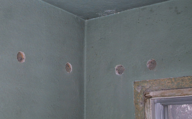

  2. On the main floor, there are 3" diameter holes drilled into the plaster, seen in Photos 2 and 3.

To humor you the place is undergoing some DIY remodeling work.
New improper vinyl dryer hose leading in to the crawl space adding humidity and possible mold growth along with creating a fire hazard from heat and lint build up with that Home Depot P.O.C.
The Homeowner also went out and bought a hole saw drill bit to add insulation while looking to upgrade further by removing the old trim around the inside windows…
Have no idea what is inside the walls as far as the sheathing goes or if this is a brick home.
OK took another look and this must be a brick home so he may be creating a mold trap between the brick and plaster.
