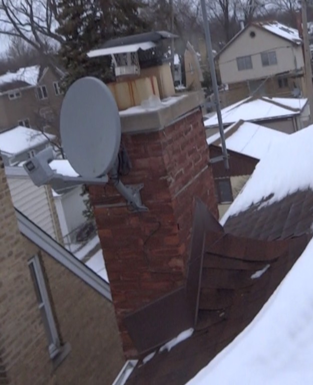

Can you see the issue ? (s)
How many do you see ?

top left/4th house off corner has a leaky basement, got milk?
No rain cap on the house beside it??
I do like the liner with no seal at the cap. Make the chimney nice and warm then leave a big opening at the top for local bat population.

Hi Bob,
Couple of comments; I am never a fan of dishes and antennas attached to the chimney; damage can result. The other comment…are you concerned that the furnace exhaust is spilling down the fireplace chimney into the home…do I see that the lower rain hood hood is obscured by the fireplace rain hood.
Yes that is part of my worry but not sure if that shoud be a concern.
Firebox has openings which is bad enough.
Attachments is yet another that you also noticed.
2 points

I like the flashing.

Bob said 's. more than one. :slight_smile:

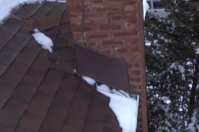

I am concerned by the wrap around flashing as I had no idea if there was step flashing under it.
Snow conceled the space.This was a video cam observation due to the weather.
It was pretty dark ,but I brightened up some shots.
I will give you one point Kevin though you are hiding your doubt with the non commital joke observation. :slight_smile:
I actually have 2 more concerns based on what you see.

Missing kick-out flashing
It would be nice if they had some kick out flashing but I never see it.
