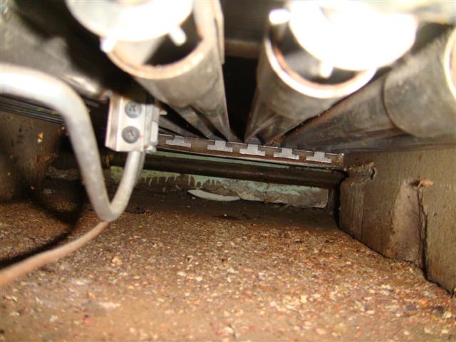

Can you spot whats missing?
15 year old boiler.
Whats missing and how should I write it up.
Hint:
One of the materials may not be what you think it is at first.
What’s a “Boiler”…July in Arizona?----:stuck_out_tongue:
What is supporting the burners?
Yeah good call,you get a prize from the middle rack.
If you want the big teddy bear ,give me some wordage for the freakin bottom of your boiler is missing.
That’s the concrete basement floor.

I would simply state the Boiler needs to be repaired-replaced by a licensed HVAC contractor (or plumber) in your area…I do not really know, very seldom do I find one still operation in a commercial building, I have never seen one in a house.
Very common here in older homes and apt buildings.
This was a Chicago Bungalow which you may have heard of.
The listing said 1956 but the toilet tank lid said 1929.
