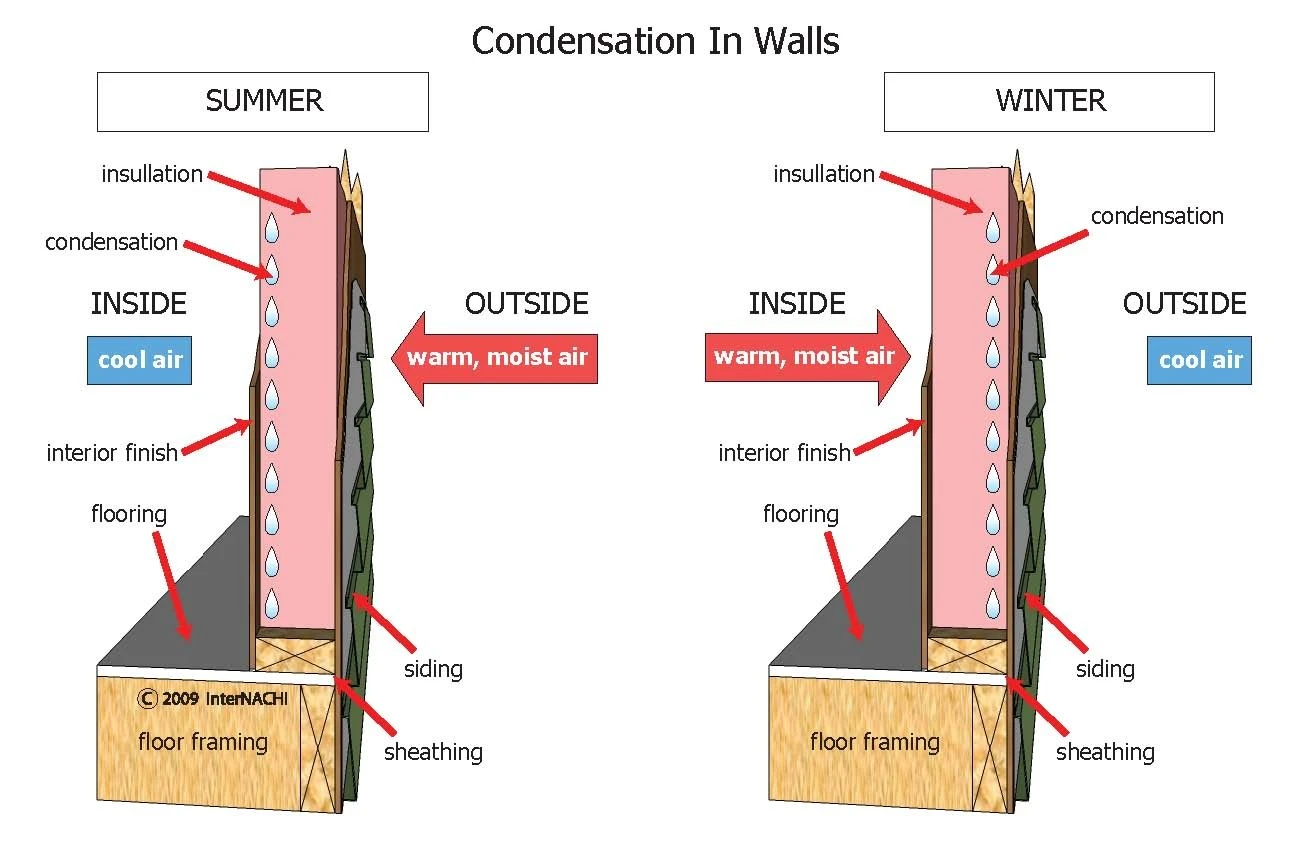

Being as the home is in Orillia, ON, Canada, Orillio Ontario - Search (bing.com) which is surrounded by large bodies of water, I would lean towards a localized condensation issue. I believe the installation of vapor barrier on exterior walls has been required for some time in that area. Whether it be inside or outside, if moist air can get trapped behind the moisture barrier and insulation, well . . .
Since only the OP knows what the exterior looks like, and hasn’t provided much info to go on, then the evidence provided points to condensation as the suspect.

Roger am I to understand from Your pictures that they used a house wrap on the exterior and plastic sheeting on the interior? If so we stopped doing that here a long time ago becaused it tended to trap moisture (condensation} insde the wall cavity…now Im not in Canada, but im just across the lake, Im thinking You would have similar issues there…
Don’t the codes call for vapor retarder for your climate zone (#6)?
on the exterior of the sheething only, there was a time they tried adding a plastic barrier also on the inside of the framing behind the drywall …that process was discontinued here because of all the condensation it created in the wall cavity…

As far as the OP’s issue, a million things could cause it, and my bet is it was not caused by the presence of a vapor barrier. When a vapor barrier is the culprit, majority of the wall looks the same as that isolated, small, spot in the OP’s pic. It is impossible to know what caused it from 500 miles away, especially without knowing exactly how the wall was constructed before the homeowner gutted it. It’s fun and all to play a detective but most of the posts are doing nothing but guessing, if we are to be honest. For example, there could easily be improper installation of the exterior cladding, causing that spot to get wet. What needs to happen is a consultation with a “local”, experienced, builder/contractor to evaluate the wall assembly and recommend on how to close it back up correctly so it does not cause any further issues instead of all the guessing.

The internal vapour barrier (a plastic sheet), remnants of which are still visible, has been stapled to the studs and not sealed in any way. Could this be a contributory factor? Should the boards be chaulked along their seams from the inside too?

I initially took off the lower half of the drywall and left the upper half as initiall I was looking at where the wiring was. As the lower halves dried out, I could feel moisture behind the insulation against the wall where I had left the insulation and drywall in place. So this suggests to my layman mind that it could be condensation… although perhaps nothing should be ruled out initially.
