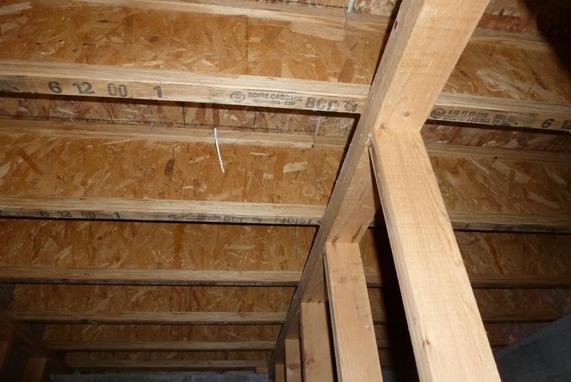

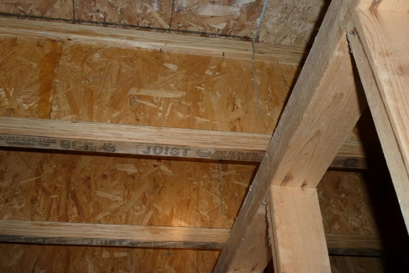

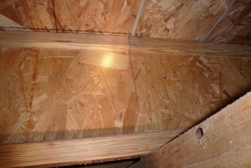

The attached photos show a series of manufactured joists that span an area about 10’. They are supported on the ends by a foundation and a beam. In the middle is a 2 x 4 unfinished “wall” and these joists are all cut about 3/4s of the way down from the top. The cut line is almost, but not directly over the unfinished wall. Why? Why? Why?
My only thought is that somehow, someone cut through from the top and then put in the support wall to “fix”???
Looks like the crown of the joists was installed downward and they had to cut it to bring up the joists to the correct floor height. Was the cut spread?
I-joists do not have a crown built in. It looks like someone screwed up to me. Those appear to be 11 7/8 TJI’s. Thsy can san a max of 15’6". If they felt there was a crown, that is the wrong way to fix it. Write what you see and include if there is a footing or not.
Looks like the crown of the joists was installed downward and they had to cut it to bring up the joists to the correct floor height. Was the cut spread?/QUOTElked with either side up.
No spread…just a vertical cut on everyone in this area. I thought this brand could be instaa
Yes they can, just figured if they had a few with deflection/crown this may have been the resulting brainstorm. This is a method which I’ve seen used on 2x joists at times to bring down a crown or bring up deflection. Frankly, it’s nuts. Who knows what this is, I’m interested to see everyone’s theories.
fat fingered that last comment…thought these could be installed with either side up. They are straight. Looks like a 2 story load bearing wall above. The joists are not flexing. You have to zoom in the pic yo see the cuts.

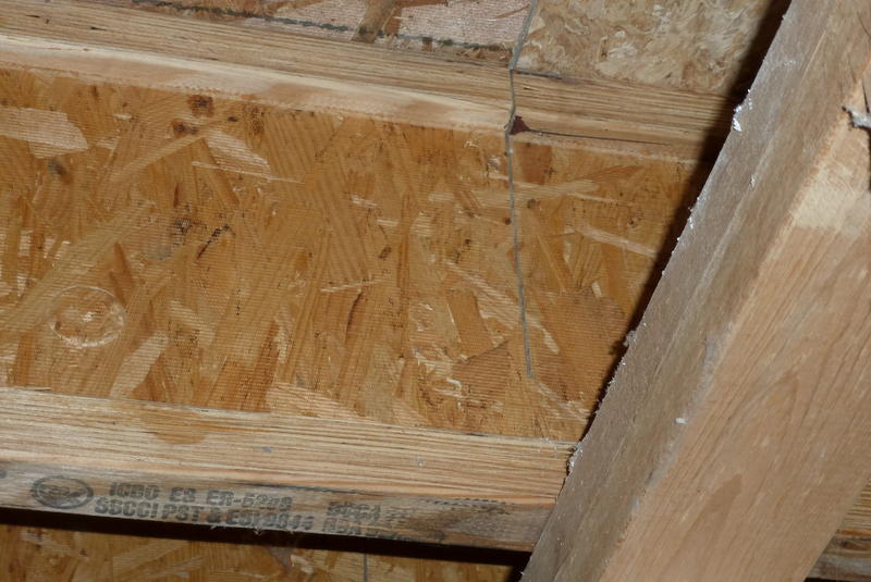

Take a look at the second photo. There is an adhesive smear on one side only of the top chord. Could this cut have been made by the manufacturer? It’s pretty thin and straight and I don’t see one splinter of tear out. That would be quite a feat to perform on site by a framer.

My theory on why they are cut like this is they were gang cut standing up but the blade did not make it all the way through. They made the first cut and then realized they messed up. Instead of ordering new they installed a wall under it. I used to own a 12" skil saw and would do the same thing. Cut through as deep as it would go and then flip them on their side to finish. JM2C.

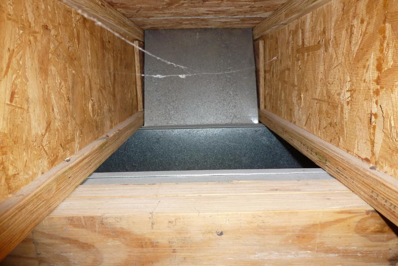

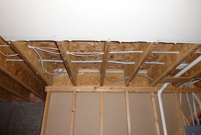

Well, it took some time, but I may have found the answer. As we went through the basement inspection, I noticed some light coming through the subfloor (pic 1). It was openings cut for air return - the return plenum had not been closed up to complete installation! Then, found three fire code gypsum panels screwed to the ceiling …hmmm WTF? Said "I’d really like to know what’s behind that. The realtor says “Tear it down.”! I say "No, can’t do that, but the client says “I will”, and pulls one down (pic 2). Well, well - there’s some cuts through the subfloor and I can see all the way up to the 2nd floor. So I go up there and find a return air grill, shine a light down and, yes it’s one of the holes. Then I check the return plenum again, and it is open on this end too (pic 3). So the guy had never finished enclosing to bring air back from another room. Then I check another room upstairs and it too has a return grill but no path through the wall to basement. This is above the area where the joists had been cut. He must have been trying to get an opening (pic 4). see patched OSB…and just gave up. Then put up a support wall to “fix” the cut joist mistake. The End.
