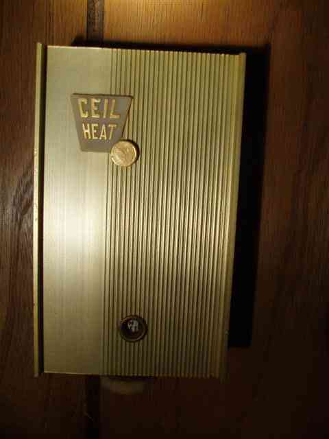

"Ceil Heat" question
Anyone know anything about “Ceil Heat”? Is it completely independent of the air handler? Is it a radient heating system only? The system has electric strips in the ceiling. Since warm air rises, I question the effeciency of this type of system. House age is early 70s.

I inspected two houses this month that had this exact set up. The homeowner (engineer) that installed the second one, told me they are very efficient. He had his last 3 years electrical bills out for us to look at. According to him, if the heat can’t rise(ceiling),then it works its way down to the floor. It took about 30 min. to raise the temp 10 degrees in the rooms I tested. Owner said he keeps these controls set on 70 during the cold months. There is no air handler needed or required. One house did have ceiling fans in every room, though.

I did an inspection just last week that had ceiling radiant heating installed. It was the first time I had seen it but from the research that I gathered because it is radiant heating it doesn’t matter if it is on the ceiling floor or in a wall. Because it radiates heat like the sun as long as it can see what it is heating it will heat. So what I mean is that it will heat your furniture and walls and you it isn’t necessarily heating the air but radiating heat to objects that are in the path of the heat energy. You are correct that hot air rises and would not make sense to have it in your ceiling but because it is heating the objects it seems to work well. With a forced air system the air temp reaches a certain temp and the heater shuts off but your floors and furniture might still be cool. It was popular here in San Diego for a while but we have a very mild winter. In a harsher climate I don’t know how well it would work. I did find that there are at least two types, panels that go on top of the dry wall and, a cable type that is put on the drywall then skimmed over.

As Roy says these are Radiant heat systems. It heats in the line of sight. Under tables and chairs are not heated only the objects.
Many homes here in NW Ohio have this radiant heat and yes they are efficient. Not easy to repair, but takes time. You can use a standard tic tracer to follow the cables or dampen the ceiling to find breaks in the wires. Patching takes training. Some cable heat has 2 layers of drywall with the cables between the layers. These can be patched from the attic on 1 story homes easily.
