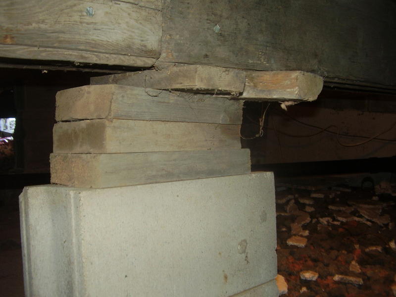

Well, we sure have discussed a block pier to death by now and no matter if it looks like this PierAndBeam curtesy of APA.jpg or not, unless there are signs of sagging, breaking of the pier, I would probably leave it alone and just mention that the pier would be better if it were capped with full bearing pressure treated lumber to utilize the full capacity of the hollow block.

I just thought it was funny that you posted a code section that directly contradicted your pier orientation and snap theory, without rethinking your position or finding some other industry standards or documentation to support it … which don’t exist.
I don’t think Marcel will be here to save the day for you, as he seems to be on board now with the rest of us that the pier cap is the real issue, not orientation.

Here are some more pictures to stretch out this discussion on proper orientation. I am hoping to hit all time high of 1000 posts. Don’t quit now Robbert O you are on a roll.
Deficiencies.
No cement cap.
No termite shields.
Moisture stains.
Bad bearing point.
Looks like the ones in the worst condition are running parallel to the beams … :wink:
