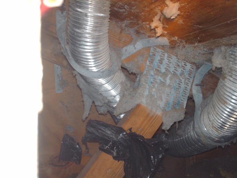

Some do not read the instructions on their dryers that say to clean the lint screen after every use. All that moisture laden lint ends up getting caught in the bends, clogging the lines. Then it takes longer and longer for the clothes to dry.
I just inspected a home where the homeowner replaced the dryer with some new fancy unit. Guess what? The clothes still didn’t dry!
He installed a new line and all was fine.
The problem was that the old line was ribbed, which isn’t allowed, for obvious reasons. See picture below.

That was the point to my question about added force to aid the dryers blower in projecting the lint upwards.
There are many factors that will cause that substance ‘‘link particles’’ to ad-tear to surfaces.
> Moisture , ribbing in the channel of the tubing, any exposed fasteners that enter the tubing-self tapping screws for holding links of galvanized or aluminum tubing together.
The end problem is clogging,as you have exposed in your photo’s.

Vertical dryer vents seem to be installed much of the time without req’d backdraft prevention devices.
My last new construction inspection, they just ran in up through a B Vent Cap, which can make it hard to catch as it’s a new home, doesn’t look out of place and there’s no lint… yet.
Is there no way to send down a scope for viewing.
I am asking out of ignorance for not having seen a example installed.
I have only repaired and inspected side venting.
Is the any way of asking the manufacturer or installers of ways to spot improper installations?
Robert
A scope may be helpful, but not really necessary. It’s not going to be mid-run in the dryer vent. It should be at the terminal end of the vent.
On new construction, I can use a mirror, looking up a vertical dryer vent and see if backdraft protection is in place. When they are full of lint, it’s a little harder, but the same applies. If I have gone into the home ahead of stepping on the roof, I have a better idea of where this should be.
