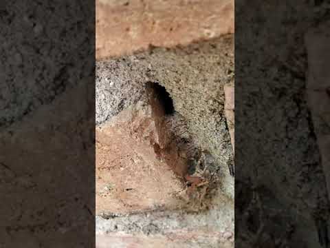

Chimney leaked out chute door, shoot
wanna try hand digging this puppy? :ghost:
Bubba wants to see Everdry etc dig this in 2 1/2 hours with no milk
some pretty blue clay, our favorite , they tossed in wood and other trash = morons
Inside basement on opposite side wall, some mold, deteriorated rod holes eh.
The interior basement system bubbleheads would have cut the bottom of drywall and installed their terdball water diverting system, they would not have bothered with plugging the rod holes, certainly not the upper rod holes, can you say more mold, Bubba can, Bo knows and Bubba knows, DannY beer cans man doesn’t know or doesn’t care, dig?
There appears to be a reoccurring theme in the foundations you repair. Lot grading and heavy impervious material or poured concrete hardscaping next to the foundation.
I duggem by hand before.
Lot grading? No, there WAS concrete UP-AGAINST this chimney, all the way around chimney, up tight and it was sloped away lolll so much for moron water management = for rookies - also case you’re wondering, the back and front yards are sloped away, oh yes indeedy
Yes, moron builders and city inspectors and CODES think it’s fine to backfill with clay soil, this is just the dumbest shit - Mr builder does it because Mr builder either doesn’t know better or doesn’t care because backfilling with this type of shtt is easier for him
the reoccurring theme is always, one or more exterior cracks, cracked parging, deteriorated rod holes etc
