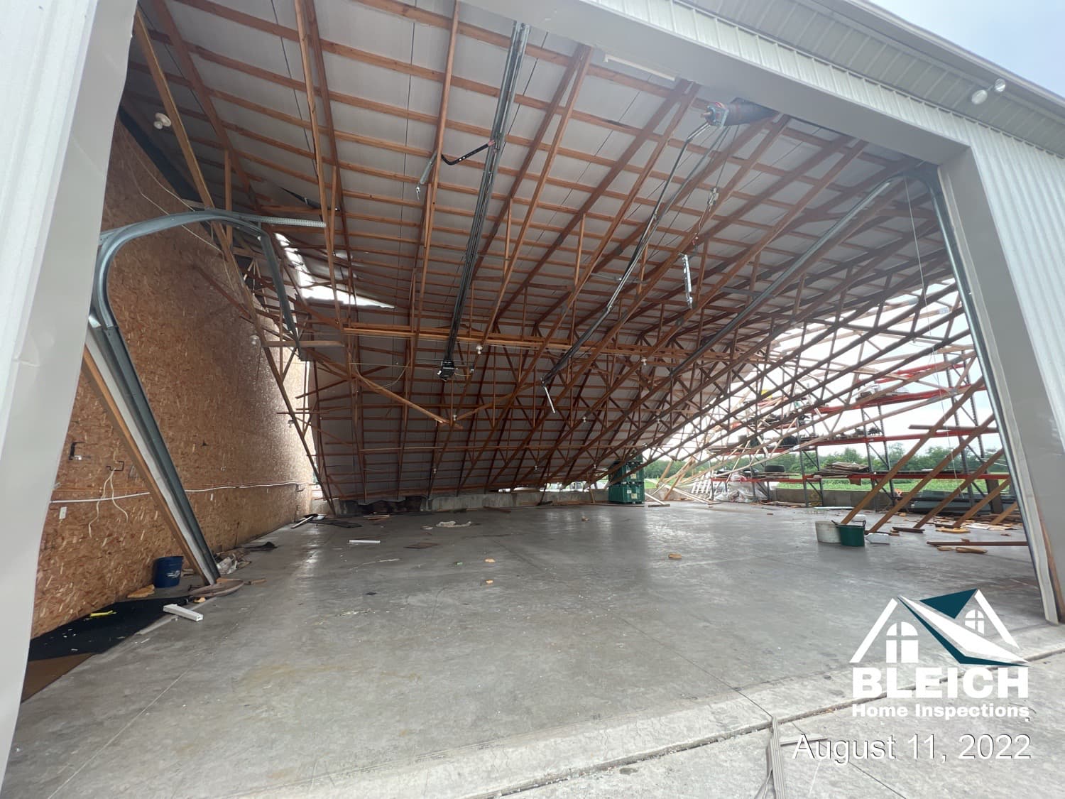

Heres a damaged warehouse from a derecho we had about 6 weeks ago. It appears that the wind lifted the roof, the wall fell over and the roof came crashing down.
Was it under construction? Was anyone hurt?
It was built in 2006. No one was injured as far as I know.
The “what can happen”, people often ask.
Hurricane force winds with an open garage door. Will happen everytime.
Any large openings or if some windows blow out the internal pressure goes up and so does the roof typically.
