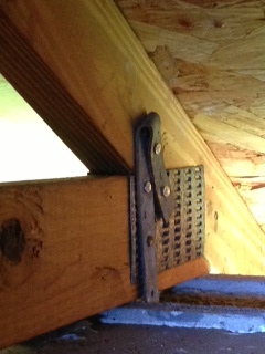

Clip or no clip?
What ya think? OK like this or does it need to be flipped up?
See it all the time, only most framers don’t set the tail end when bent over. Its got 5 nails in it…clip
Clip
Is it a 1/4" strip of metal, embedded into the tie beam that has at least three nails in it?
Clip
€ [FONT=TimesNewRomanPSMT][size=2]Secured to truss/rafter with a minimum of three (3) nails, [/size][/FONT]**[FONT=TimesNewRomanPS-BoldMT][size=2]and
[/size][/FONT]€ [FONT=TimesNewRomanPSMT][size=2]Attached to the wall top plate of the wall framing, or embedded in the bond beam, with less than a [/size][/FONT][FONT=TimesNewRomanPSMT][size=2].[/size][/FONT][FONT=TimesNewRomanPSMT][size=2]" gap from
the blocking or truss/rafter [/size][/FONT]
[FONT=TimesNewRomanPS-BoldMT][size=2]and [/size][/FONT][FONT=TimesNewRomanPSMT][size=2]blocked no more than 1.5” of the truss/rafter, [/size][/FONT][FONT=TimesNewRomanPS-BoldMT][size=2]and **[/size][/FONT][FONT=TimesNewRomanPSMT][size=2]free of visible severe
corrosion.
[/size][/FONT]€ [FONT=TimesNewRomanPSMT][size=2]B. Clips
[/size][/FONT]€ [FONT=TimesNewRomanPSMT][size=2]Metal connectors that do not wrap over the top of the truss/rafter[/size][/FONT]
It is an odd one but agree with everyone else that it meets the minimum for clips:mrgreen:**[FONT=TimesNewRomanPS-BoldMT]
**[/FONT]
clip.
