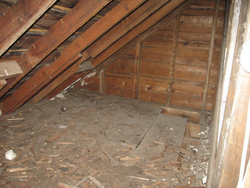

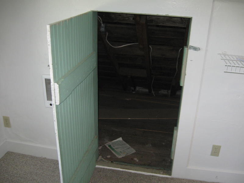

The only indication of a closet area in the room was a access door about 3.5 feet high that opens into a partialy finished section of the attic. Can this be ok for a bedroom closet?
That is not so much a closet door as it is an access to the crawlspace. Very common to find that here (SW Ohio) in houses that have added living space to the attic.
P.S. I have seen storage in such areas and I disdain that practice. The joists were not intended to support much weight.
I know that they would use this as storage space and the seller is calling these rooms bedrooms, however not actually a bedroom without a closet correct?
Definition of a closet is a space for privacy.
Is there a definition of a closet as relates to defining a bedroom.
Would any of you call these rooms bedrooms, or some form of bonus room due to the fact there is no “closet”?
A bedroom is a habitable room used for the purposes of sleeping…therefore what is important is egress…not weather there is a closet. I have seen 2 bedroom mill homes that do not have closets…yet they are bedrooms.

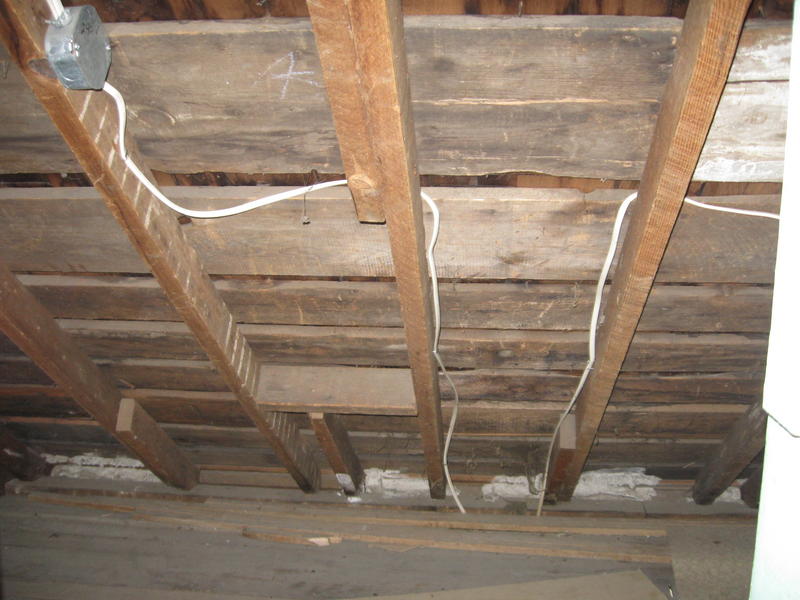

Think about it. The joists are the same as the ones under the floor. Code-required design live loads are 30 PSF for a bedroom, but only 20 PSF for an attic, so the joists can certainly support that weight. “Storage” is a different matter. In commercial work, live loads for storage can be up to and beyond 120 PSF, but a residential attic rarely sees anything near such loads.

Bedroom/study/bonus room Whatever you decide to call it, generally has no bearng on an inspection. Specifc “bedroom” requirements (AFCI, smokes, etc) may be a consideration, but if they are not there, I would still call it out. IMO it is indeed a bedroom, closet or not.
