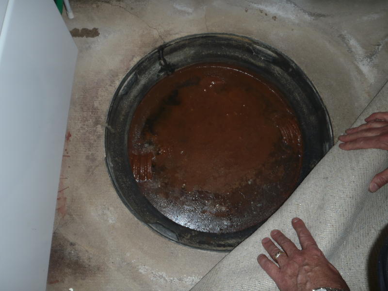

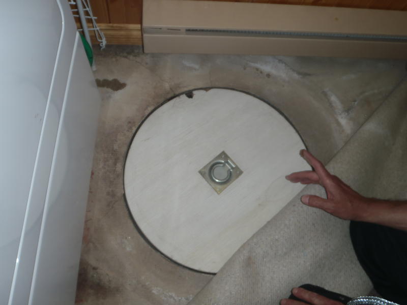

Some of the water tables on the shore line houses have it just below the basement floor level. The weeping systems installed go all the way to the shore line.
Check this dumb picture of the one I inspected last week.:frowning:
Some houses just should not have basements.
