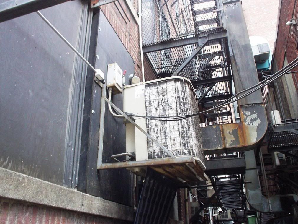

Thanks guys, here’s what we find in the downtown area of Boston:
[![](http://i230.photobucket.com/albums/ee268/electricalboston/7e0a8d51.jpg) ](http://i230.photobucket.com/albums/ee268/electricalboston/7e0a8d51.jpg)
Accessibility, working space, etc., is often not acceptable.
Do you also verify that the equipment directories are accurate?
