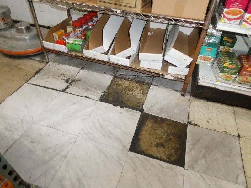

  3. A few tenant spaces were closed or not operating at the time of the assessment.

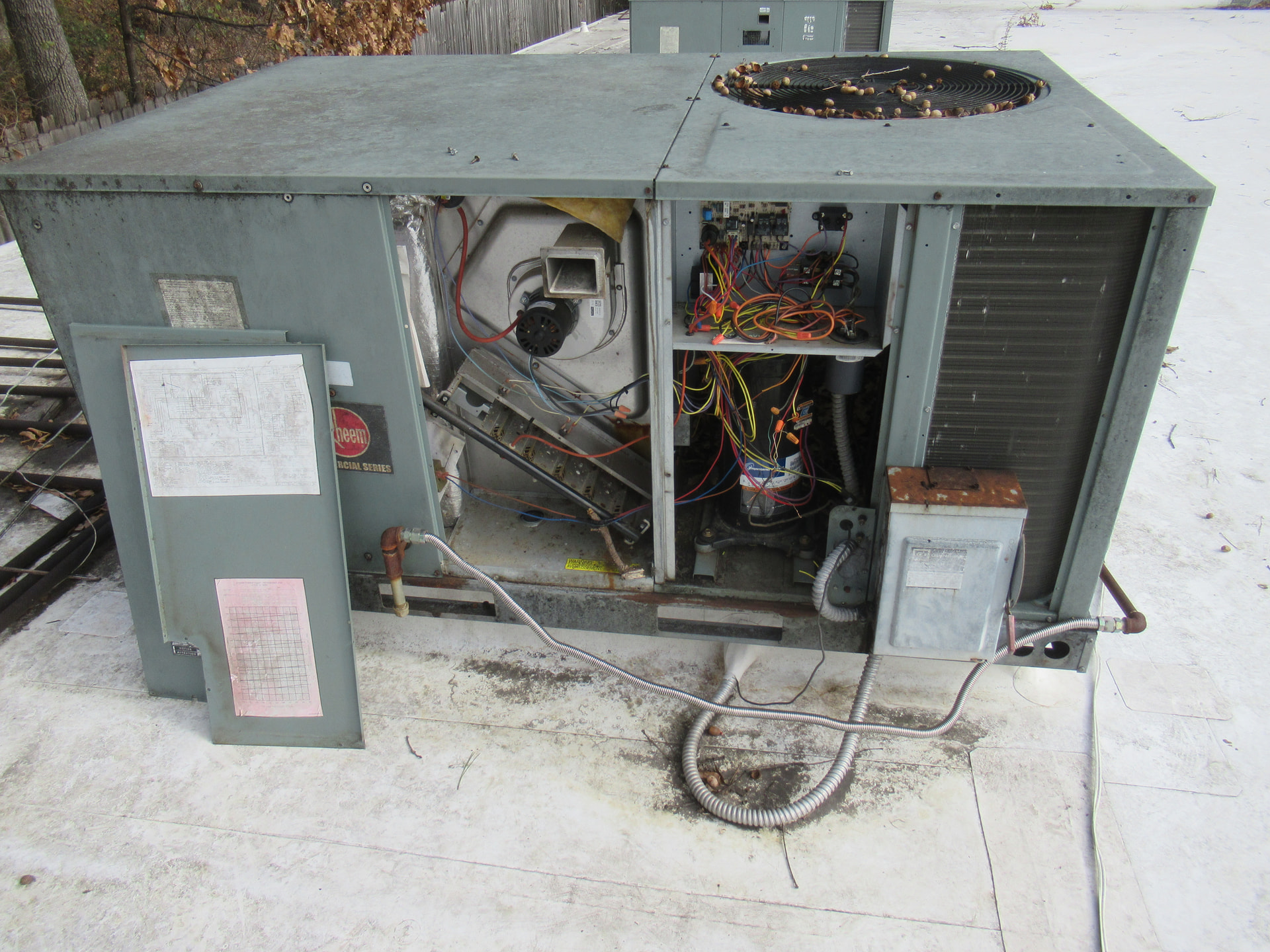

  4. Inoperable heating was observed in several suites; gas was off, and/or there was no hot water.

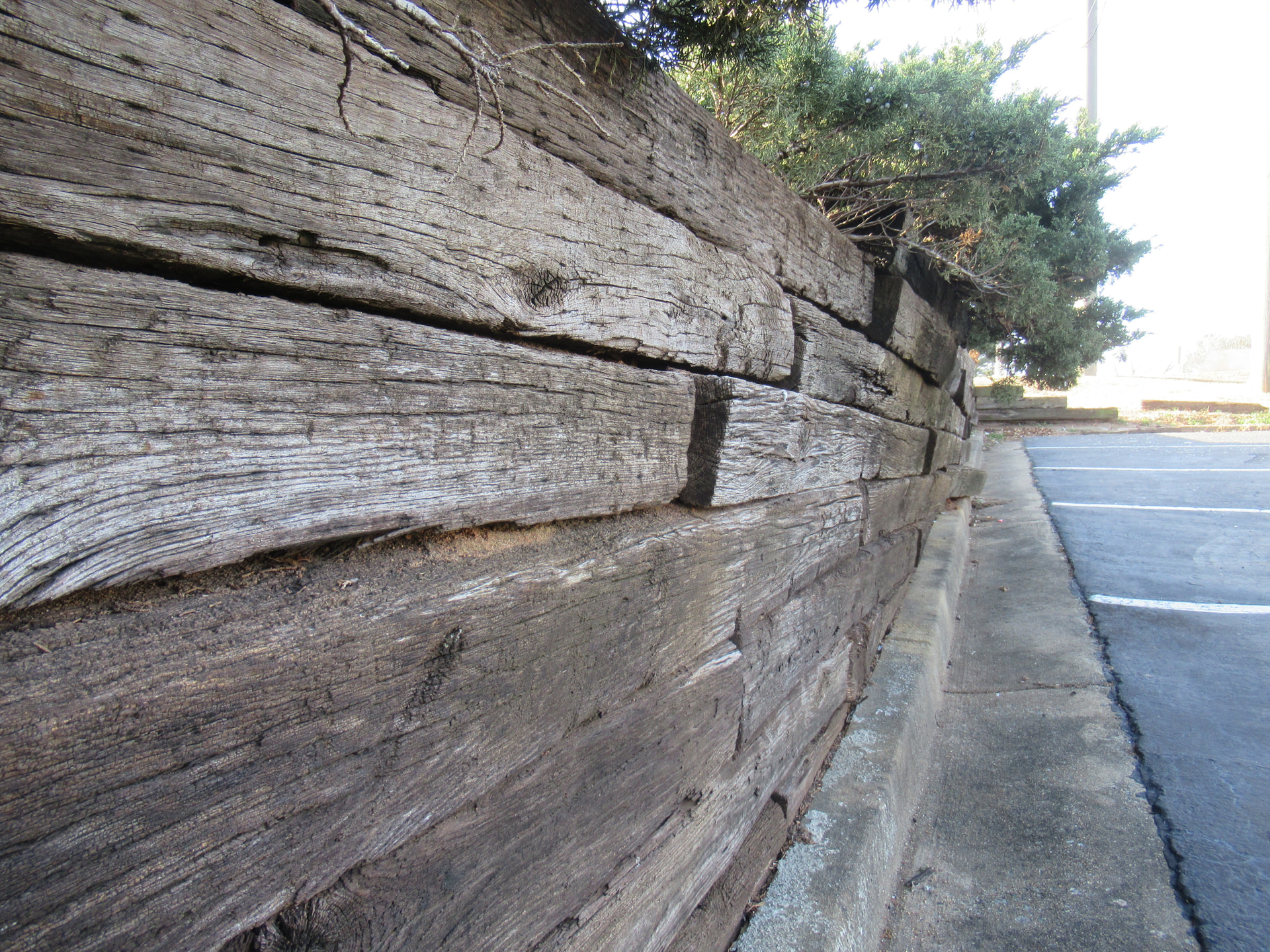

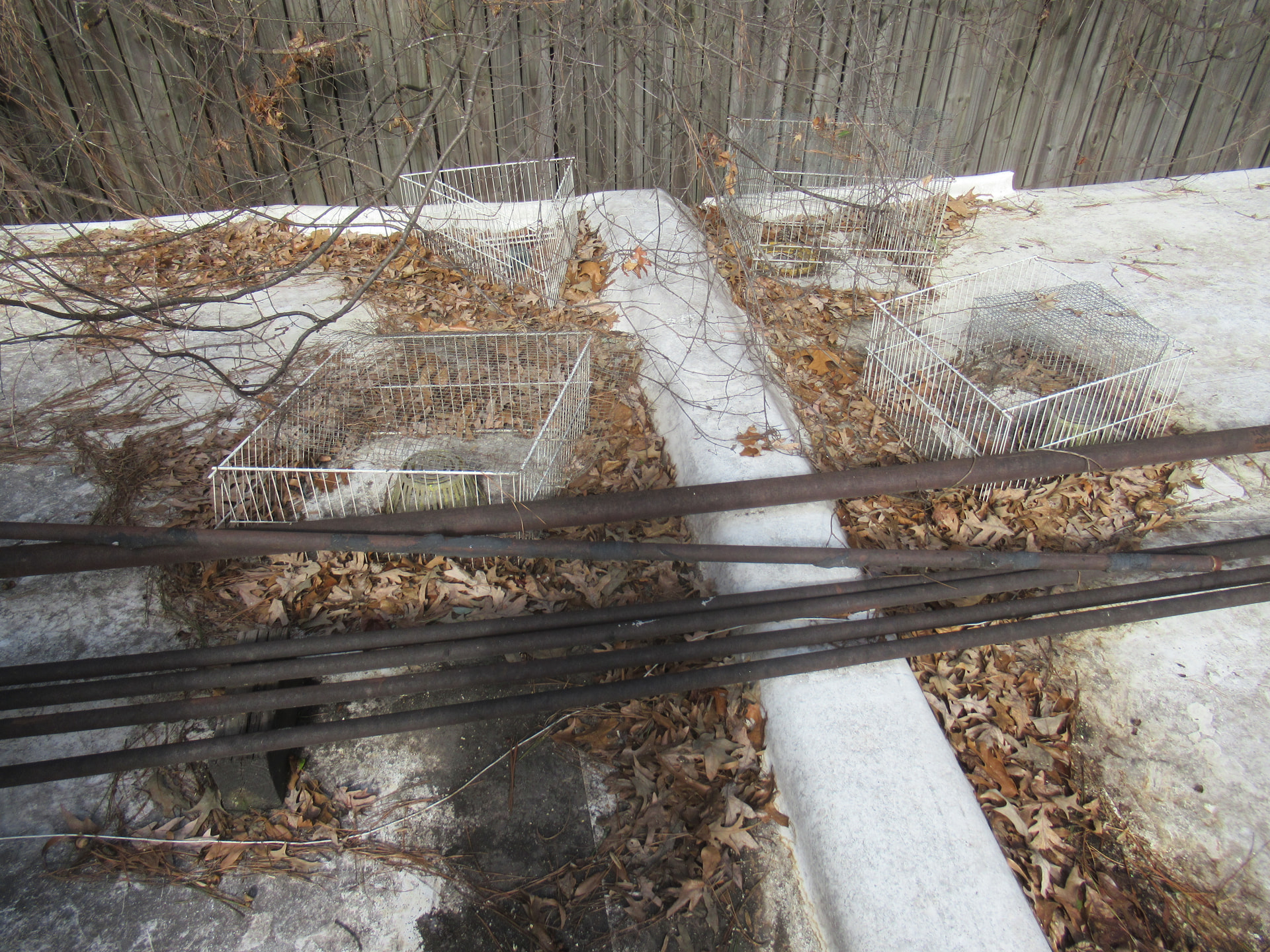

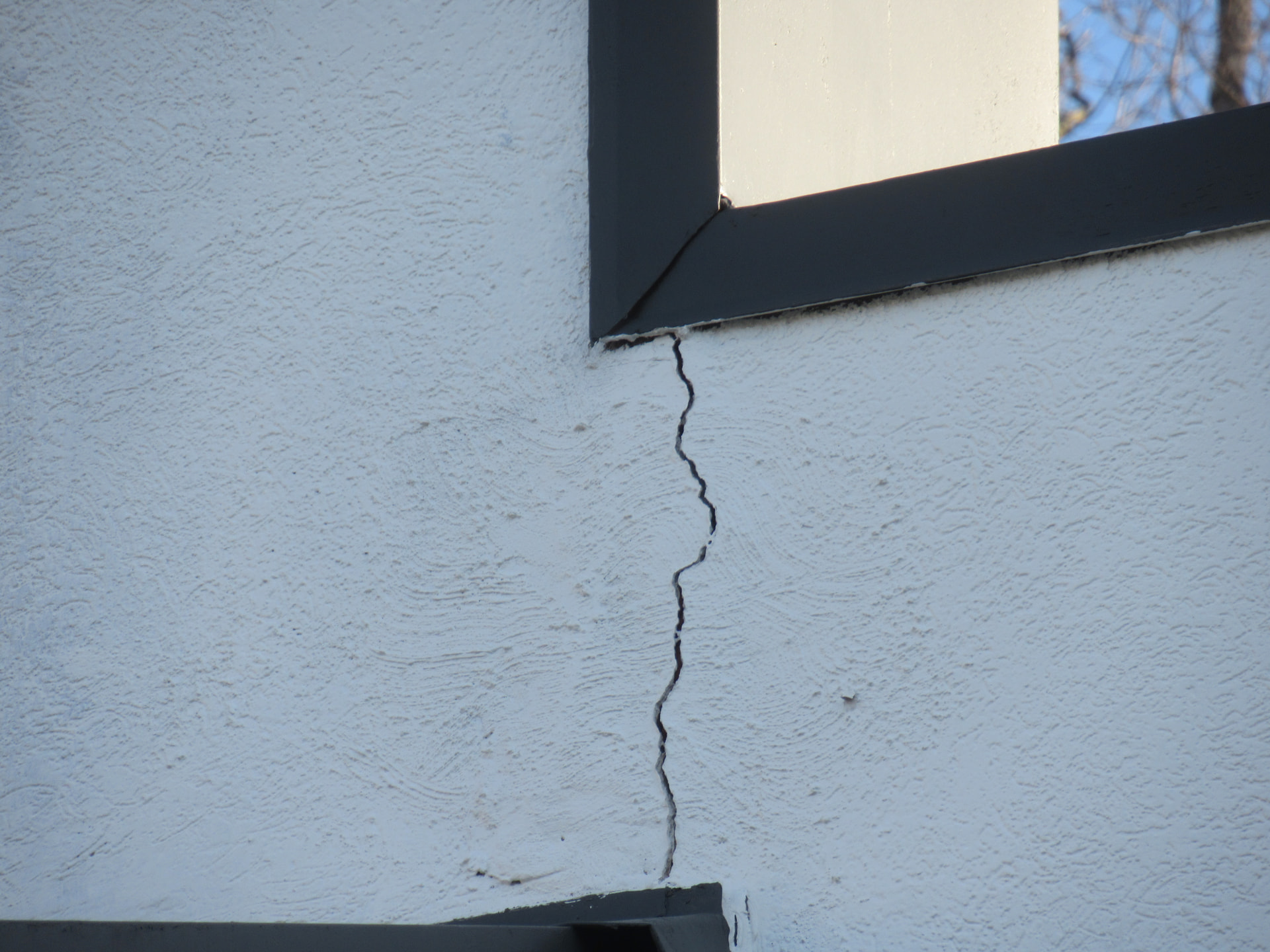

Beyond suspicions of rent roll fraud, there was extensive deferred maintenance, non-operational building systems, life-safety issues, new paint on the street-facing side of the building only, and a seal-coated, heavily degraded asphalt parking lot. Landscaping was neglected, retaining walls were failing, and privacy fencing was in poor condition.

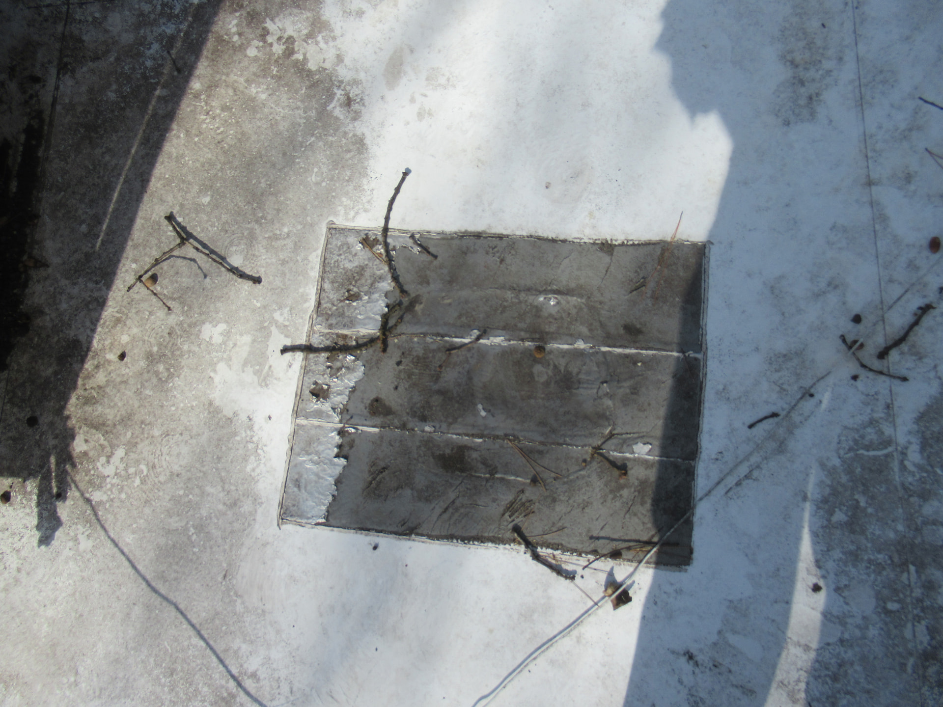

Roof covering was conveyed as 6 years old.
Bringing third-world charm to your suburban retail experience!
Must have been “dog years” :smiley:
