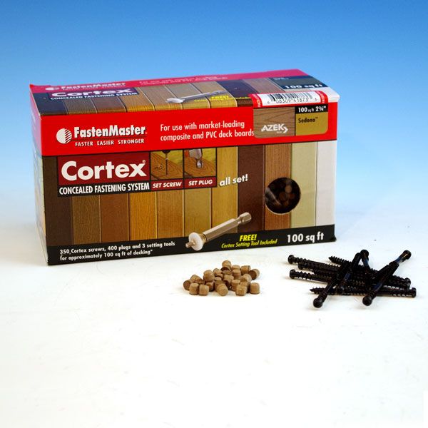

I have installed miles of the Azek brand and have had no callbacks. It works fine with 16’’ on center joists. I use the screw and plug system. It works great and looks nice. I am not a fan of Trex. It doe’s not weather well. They tend to start cupping after a few years.

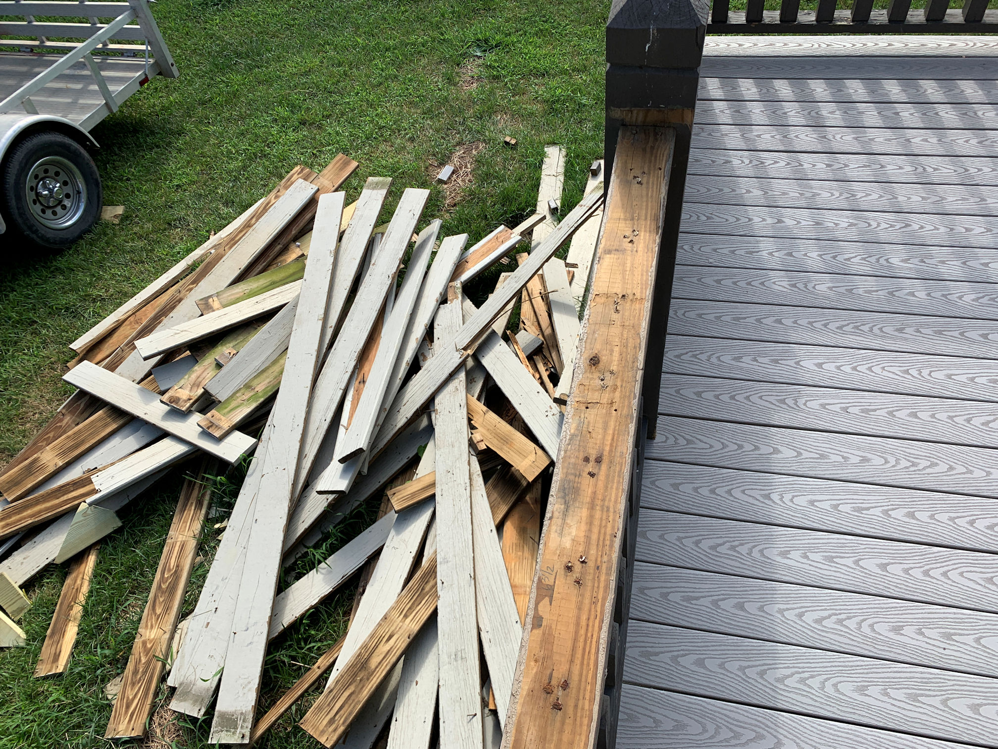

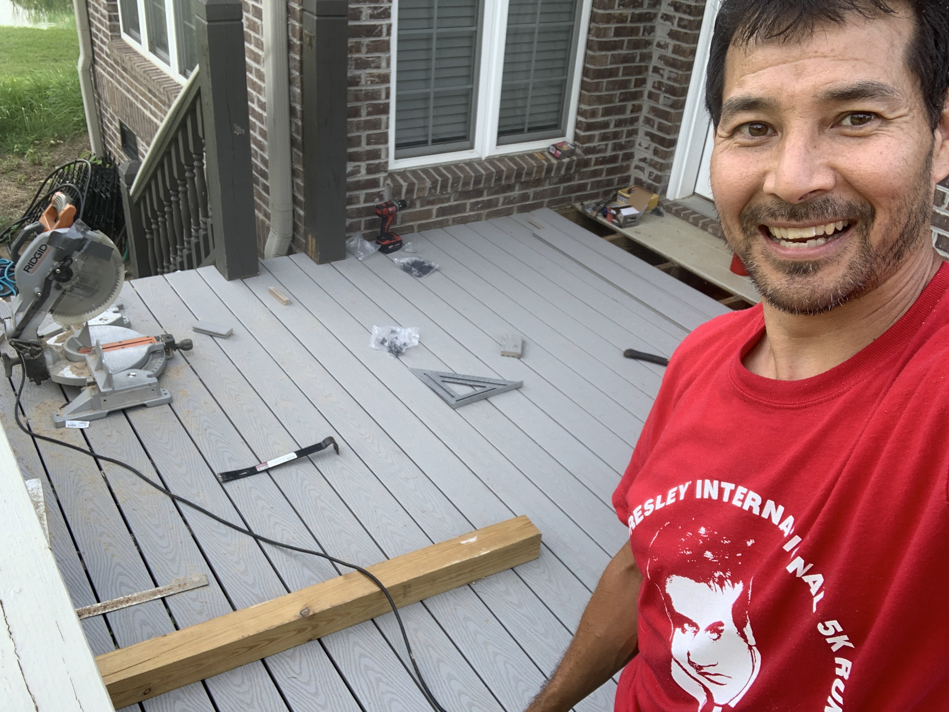

I replaced my deck planks with the generic brand of composite decking from Home Depot this past summer and I replaced the guardrail tops with pressure treated 2x6. I kept the structure which has joists at 16" OC. So Far, I have had no problems with summer heat or winter frost. They have stayed straight and flat.
As for longevity, I’ll never know.
