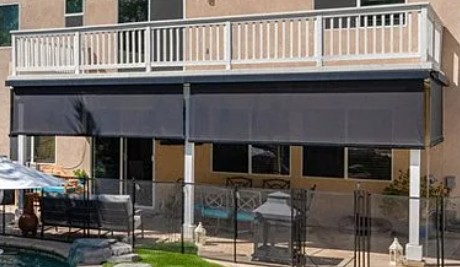

Good evening everyone. A question just came to mind as I looked up this property on Zillow that I’m scheduled to inspect this week. The home features a raised deck/balcony finished with composite deck boards, but the underside appears to be constructed with solid metal.
I’m curious how a system like this is intended to handle drainage, especially when water gets between the deck boards. Would it typically incorporate hidden drains or some other method? For those with experience, what would you consider important to look for—or potential concerns—when evaluating or maintaining this type of deck system? Thanks.

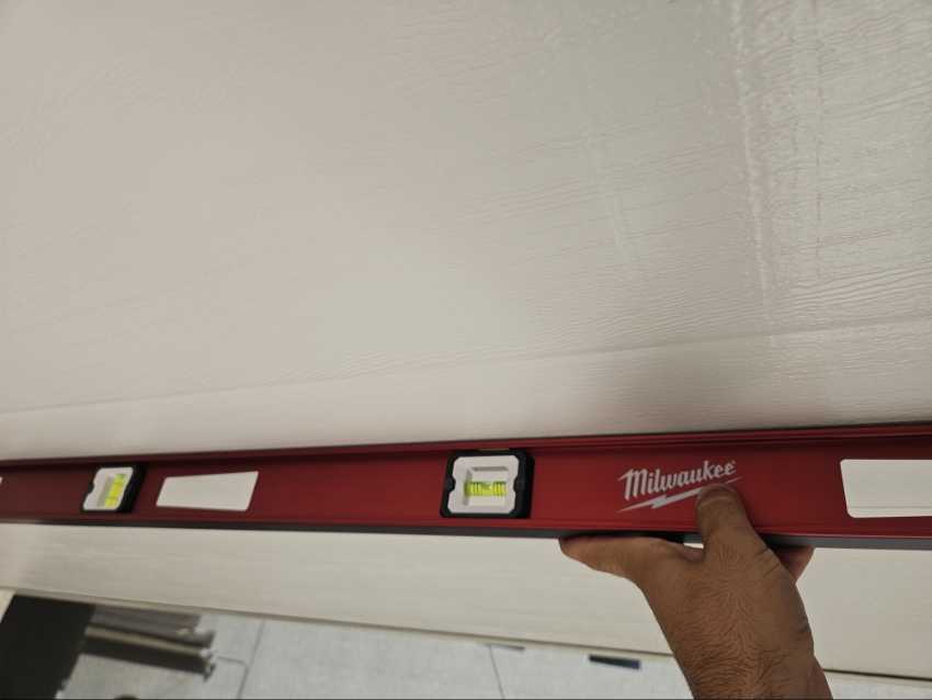

1: Use a long 4’ foot level to see if the deck has adequate slope. I also inspected parallel to the wall. I place my head on the decking looking laterally and diagonally for surface deviations. Bumps or divots. Elevation changes. When found I would use a chalkless chalk line to measure the height or depth of decking surface deviations.
Deck slope: A **minimum slope** of 1/4 inch per foot translates to a 2% grade, especially at the bottom of the slope, and how the bottom under the decking is finished. Can debris and water be trapped there. The slope should be continuous beginning to end.

There are all types of designs. This appears to be a roof structure, likely with rolled roofing material with an added walking surface. I have seen a few different systems under those deck boards that are specifically designed to elevate the walking surface and allow drainage.
It could drain over the edge, have hidden gutters or hidden floor drain. Be prepared for it not to be 100 percent visible.
Google “decks over roofs”
[https://www.jlconline.com/how-to/exteriors/decks-over-roofs\_o](https://www.jlconline.com/how-to/exteriors/decks-over-roofs_o)

![image](https://global.discourse-cdn.com/internachi/original/4X/0/3/b/03bbfa4114b89d6a9575700552cebc92ba0de2dd.jpeg)
Right lower corner looks to be a “Rain Chain” downspout, and the guardrail base may contain a hidden gutter (catch system) directing the water to the chain system.
Sample photo from Google…
 ![monarch-rain-chains-rain-chains-18105-44_145](https://global.discourse-cdn.com/internachi/original/4X/b/9/4/b94bddf584ebfd5321c57bd87324623a08249173.avif)
> **[Google Search](https://www.google.com/search?q=gutter%2Bchain%2Bdownspouts&rlz=1C1ONGR_enUS1027US1027&oq=gutter%2Bchain&gs_lcrp=EgZjaHJvbWUqBwgCEAAYgAQyBwgAEAAYgAQyBggBEEUYOTIHCAIQABiABDIHCAMQABiABDIHCAQQABiABDIHCAUQABiABDIHCAYQABiABDIHCAcQABiABDIHCAgQABiABDIHCAkQABiABNIBCTc3NTBqMGoxNagCCLACAfEFkggeKfSoexE&sourceid=chrome&ie=UTF-8#oshopproduct=gid:5459624432226346557,mid:576462385494077139,oid:11130352634933922063,iid:18310259180426679357,rds:UENfNTQ1OTYyNDQzMjIyNjM0NjU1N3xQUk9EX1BDXzU0NTk2MjQ0MzIyMjYzNDY1NTc%3D,pvt:hg,pvo:3&oshop=apv&pvs=0)**
Be sure to have a 4ft (or longer) level in your vehicle to check/verify the slope of the deck for proper flow direction!

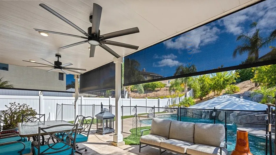

Richard. I, too, considered the underdeck dry system. However, I have yet to see those with penetrations such as light fixtures and a ceiling fan.

I wired a house with a system similar to the one I posted. We used round metal ”pancake” boxes and a flush mount “puck” light fixture, similar to the ones in the photo. The deck we wired didn’t have ceiling fans, but I think the box has a 50lb rating.
@earmendariz, keep up updated on what you find.
Just dropped $40 at Home Depot because of this 😉

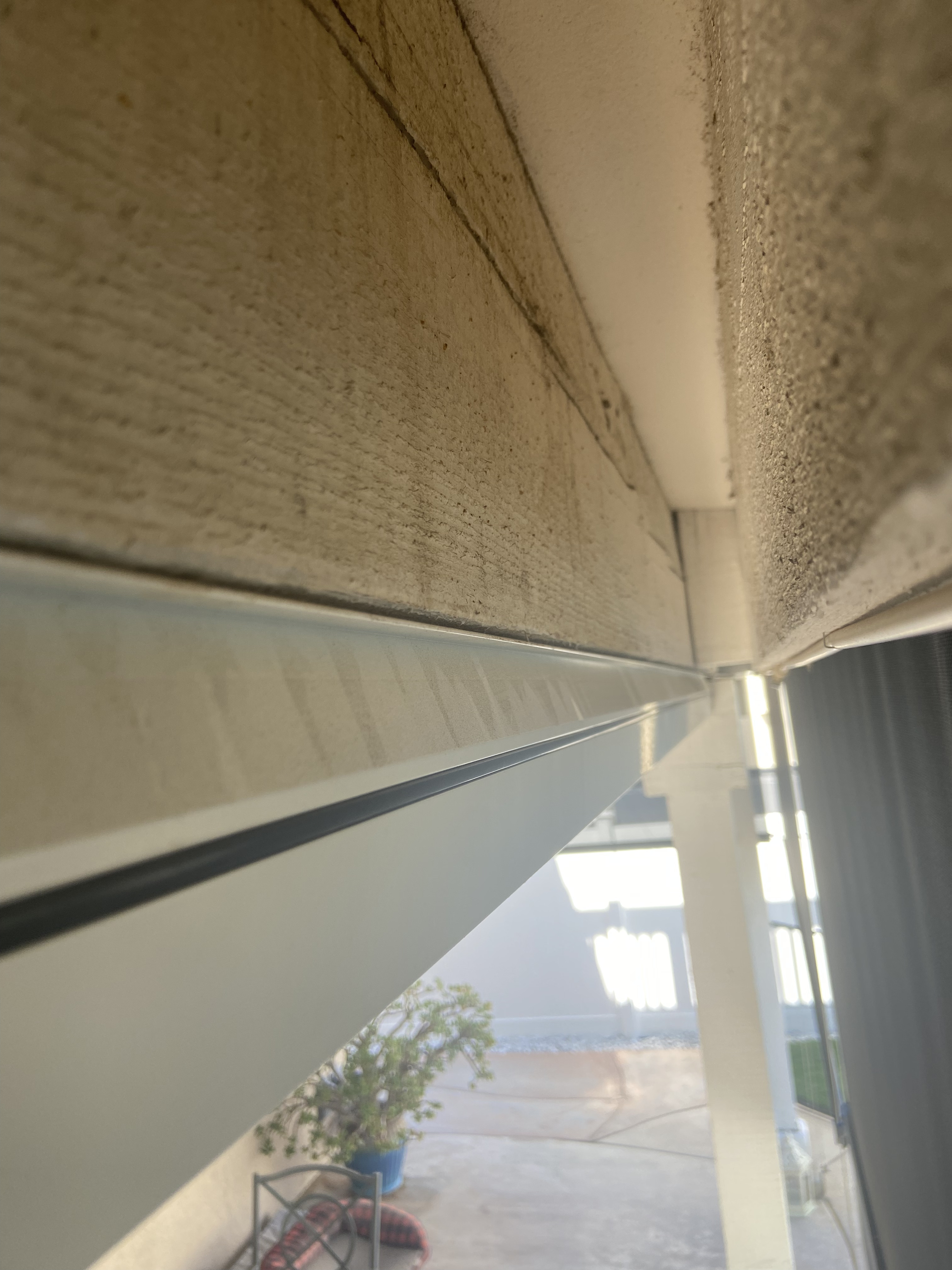

View from the front, which had this metal trim sealing the front. I thought I would of found somewhere here a place for drainage.
 ![IMG_8584.HEIC](https://global.discourse-cdn.com/internachi/original/4X/2/7/d/27d59b9f407ac6e3f21db725dc0c5df834d1dcde.jpeg)
Ever so slight pitch towards the front. But seems irrelevant if the front has the metal trim seen above.

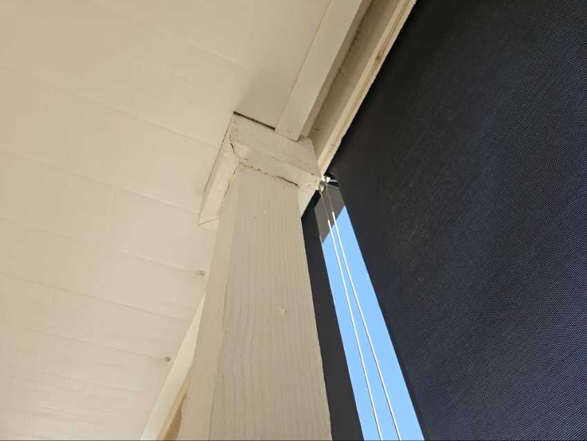

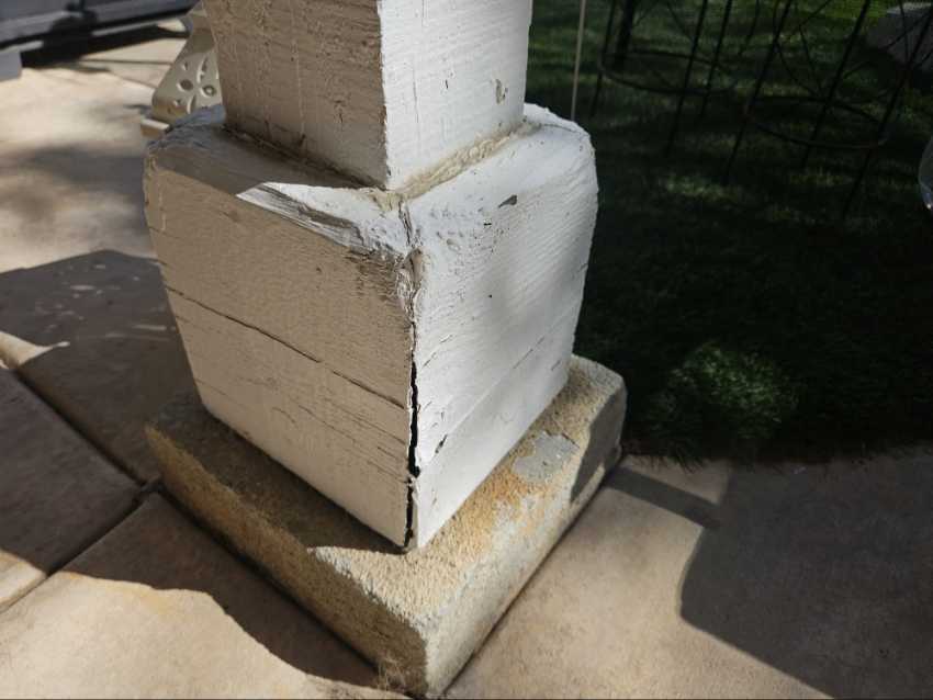

Wood posts at both top and bottom were showing wood damage too.
 ![KDyKSU_035](https://global.discourse-cdn.com/internachi/original/4X/3/b/c/3bcda11254ad2301fa73890caf05ca2d8b7b4ea7.jpeg)
 ![KDyKSU_034](https://global.discourse-cdn.com/internachi/original/4X/c/2/c/c2ccdbb41c3f0b9f76e794dcd85e7df7d0260d9b.jpeg)
