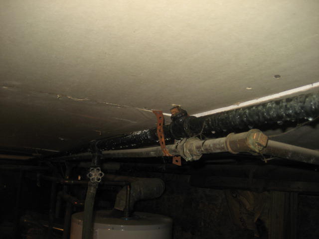

I am wondering if anyone has seen this and can tell me what could be the cause of it. I recently inspected an older home, approximately 110 years old. In the basement - which has many issues - I came across a lot of condensation on one of the water lines running across the ceiling. Most of the water lines are copper but this material is different, it looks like black iron pipe but could be something different. It has condensation formed along the entire length of it. Any ideas why?
Looks like it might be galvanized steel. And the condensation is usually warm moist air condensing on a cold surface - wet basement? Those masonry walls typically allow plenty of moisture into the basement.

what is the temperature of the incoming water?
What is the relative humidity in the space?

Thanks, I realized it was condensation formed by temperature difference. I guess what I was looking for was why on this pipe and not on the copper lines attached to it as well?
I can see water drops on the copper side too.
Just write up lack of Dielectric fitting.
