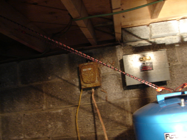

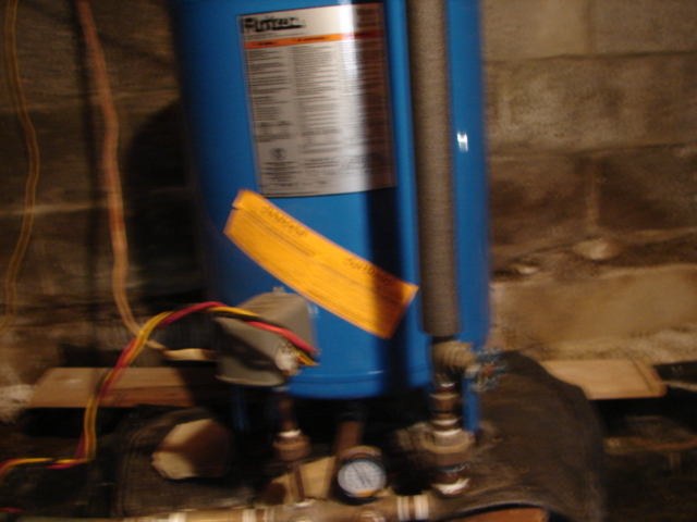

The bungee cords you may see in the background was “a stabilization” addition for the well-trol tank. :shock:
Well-trol as previously noted.
:roll:

You don’t want to be standing near if the bungee cords break ! :mrgreen:
The current owner likes to “shake things up a bit” :mrgreen:
