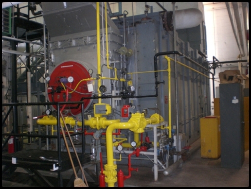

Here are a couple of images of a 100M Btu/Hr Generator/Boiler that has damage to a section of the refratory brick.
