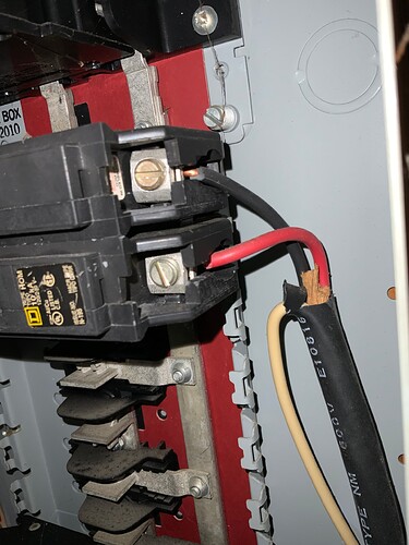

I know this type of question has been asked a million times before but I thought the gauge looked a little small on the white insulation wire going into the breaker at the top left of this GE panel. 40 amp breaker. There was no writing on the outer white sleeve to confirm but it looked to be the slightly smaller than the black wire on the opposite side panel whose wire appeared to be a 10 gauge on a 40 AMP. The AC data plate allowed a MCA of 30 AMP so I believe it is allowed. Home built 1947 NM but didn’t look super modern NM. Thoughts?

Not a problem… If you are asking about the black sheathing at the right, it says 10/3. The label says you can have up to a 50 amp breaker, and 29.5 minimum ampacity. However, this is odd, from what I usually see… Normally the breaker and the gauge are only one size off from each other, not two.
The white ones on the left look like 10, but it is too hard to tell from a photo. Is that breaker also for hvac? Otherwise it would be an oversized breaker
There are plenty of other issues wrong with that panel though.
No legend. Only the AC and a few others were marked. I know the bonding jumper was dangling in mid air below the neutral bar. One neutral was doubled with a ground and some bushings were missing. What else you got?
Other than your wiring concerns, a licensed and qualified Sparky needs to make repairs (possibly significant repairs/replacement) to that homeowner/handyman installed panel anyway!!

Jeffrey got the bushings. That SQ D breaker isnt allowed, it looks like a GE or Siemens panel.
And the feeders appear to be missing a neutral conductor, I assume the bare conductor is being used for grounding and neutral?

GE panel is correct.
The bare wire is the service neutral. The home only had 1 grounded receptacle. The ground wire is the armored wire at the bottom. Not that it much matters with just one item grounded.
I missed the square D breaker as I was so focused on that wire. Thanks. Good thing still working on report.

The white cable on the left looks like UF cable or someother type of cable, just not NM cable. You can see that the conductors are actually black and red.

The conductors in the 10-3 NM should all be the same gauge.
