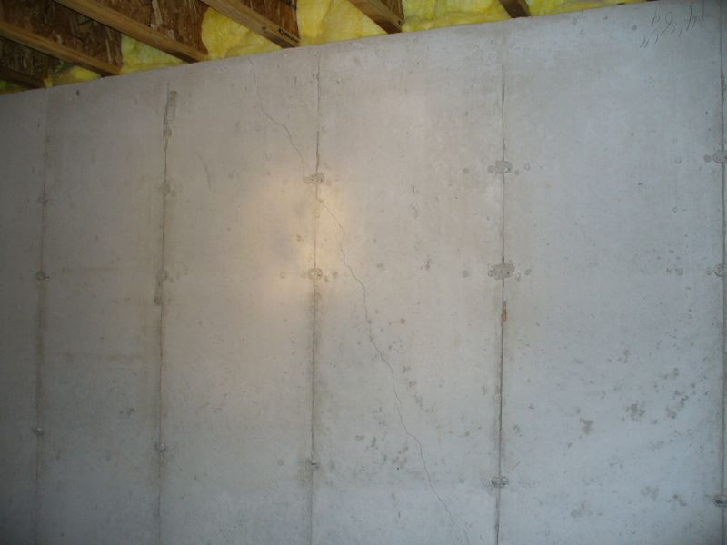

Anyone know the “typical” cost of epoxy injecting of foundation wall cracks? (Floor to ceiling, about 10ft long.) Rough estimates are fine.
Thanks in advance.
Mark

Hey Mark. I recently had a company pier my foundation. The company I did not go with offered to epoxy a crack for $700.00. The company I chose to “lift” my foundation did not do injections.
Thank Robert,
Believe it or not, this is new construction. The builders had already epoxied one crack (that still leaked). But had another crack with an active leak, and two others on this same wall that were dry. The buyers have asked the builder to epoxy all of them, but were wanting to know what the cost was incase the builder couldn’t get it done prior to close.
I had one done last winter. About 6 ft long from top to bottom. Cost me $300.
They injected the inside and then used concrete patch on as much of the outside as they could get to. (About a foot under grade) Worked good. No drips since.
Just a note, I asked the company that installed my piers about epoxy injections and they laughed a little and then gave me a tube of “Sonneborn NP 1” caulk. I went online and bought several tubes for about $3.00 a tube. Applies with a typical caulking gun. I definitely do not know a lot about the different products but so far, no leaks;)

I would have to think it would be a waste of time not repairing it from the outside in, rather than the inside out.
The entire foundation should be uncovered, sealed, pea gravel added, perforated pipe below the footing going into a sump pit, and pipe day-lighted out away from the foundation if the grade and property lines allow it.
Go to the posts from Mark Anderson…aka John Bubber, he knows everything there is to know about waterproofing in my opinion, and I agree with everything he says about these companies ripping people off with their temp. repairs.
Any injections are a temporary repair to a problem that will not last, waste of time as far as I’m concerned, I would tell a client that also.
I agree with Dale 100% and anything done on the inside will not be a cure, but temporary and a waste of money over time.
The root of the problem is outside and unfortunately, that is what needs to be repaired.

Mark,
kinda hard to tell for certain but, one pic w/diagonal does NOT look like it penetrates THROUGH entire wall so, those won`t leak unless more soil pressure etc causes them to widen. Some NEVER widen-get worse,of course some do.If they do, NO epoxy/urethane is going to withstand lateral soil pressure and/or roots,footings etc that can lean-push against exterior wall.Not all walls have exterior clay soil pressure, or roots etc agst them
other leaky area ‘appear’ to be problem/result of opening(s) at,near,along,above,just under top of bsmt wall, thats why its wet UP HIGH. Cant tell if those are cracks, IF they are same chtt apllies.Do they penetrate to outside,some do and some don
t etc.Also,they want to be sure rod holes arent going to become a problem after finishing bsmt. Some only have a CORK in dumb hole and/or exterior was only damproofed
n most likely backfilled w/garbage soil and other crap. A CORK! Is this the BEST the builder/codes etc can come up with,huh? Why not pack da ho`s with cement/hydraulic cement, this would be best for HOMEOWNERS.
cost of injections depends who people call. Most often they are as low as $250-300 and up to $650, thats what i`ve seen for 30 years here in MI.

Only POURED wall cracks these injections will last awhile in are thinner,hairline type cracks,if they are dormant. And it sure helps if SOIL on exterior wall was backfilled w/sand when built.Do these people who only-mostly do injections,do they thoroughly EXPLAIN to homeowners that exterior lateral soil pressure or roots,footings can cause these cracks to widen? Chtt, i doubt it. If they do i bet its in small,fine print on contract that most Hos don
t freakin read. People want injections fine. But when home is sold and if injection was done and the MFR re-leaks due to exterior pressure(s) and people were NOT told, its the company-contractor that outta take it up the AZ due to INCOMPETENCE,NEGLIGENCE…omitting-obscurring material FACTS facts facts.
heres what they say [http://www.omnibasementsystems.com/solutions.php?page=foundation_repair](http://www.omnibasementsystems.com/solutions.php?page=foundation_repair) i
m not with em on statement ‘a poured wall crack is generally caused by shrinkage’. believe what you like. among other things, they say… ‘if your repair method is injection alone, the crack will often get larger and re-leak’. This is true. Not all, some.
…‘Soil expansion and contraction CAUSES foundation movement and re-leaking…’ yep, sure does happen. Not just soil either, roots,footings,concrete slabs,nearby construction/equipment,underground vibrations etc
One more thing dammittt, lolol, hey, if you have vertical crack in poured wall and wanna TRY something,wanna save that cash then TRY try try this…
V-chisel the crack out, gotta get IN there,the further penetration the better.
Clean all loose chtt out.Then wet/moisten the area and apply hydraulic cement.
I said…TRY. This is most-often as good OR BETTER than injection. hey, these Cos ever tell ya to try this? Prolly not.Have had a few Ho
s who did this,couple lasted 15-20 YEARS, uh huh.I wouldn`t do it if i were selling the house,no sir.
