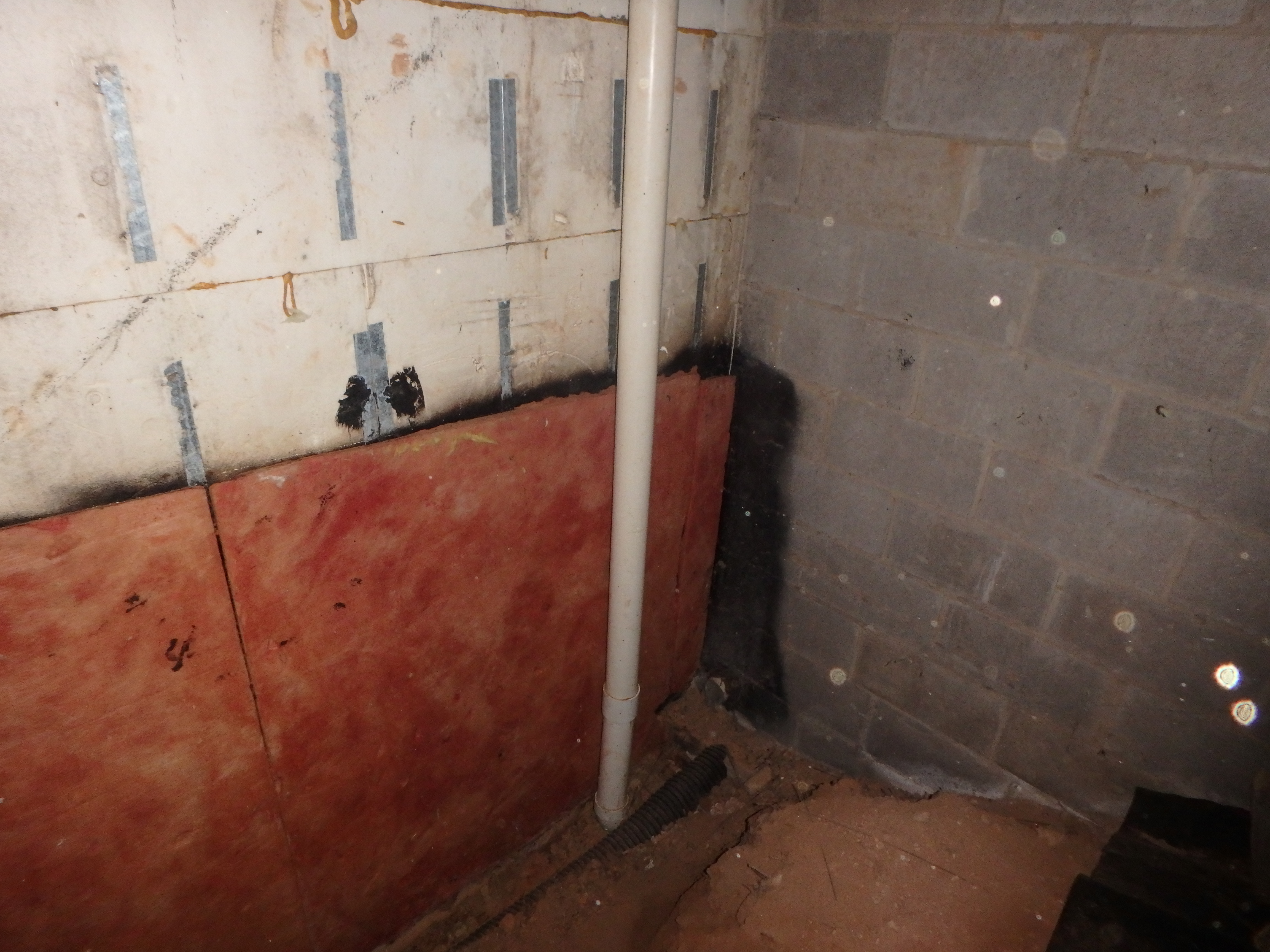

Morning All,
Home built in 1997. Insulation on wall appears to be foam board with a sheet of fiberglass insulation on lower section. On the other side of this wall is a finished basement. Anyone seen this before?
Looks like a DIY insulation job. No big deal except where in contact with the ground.
