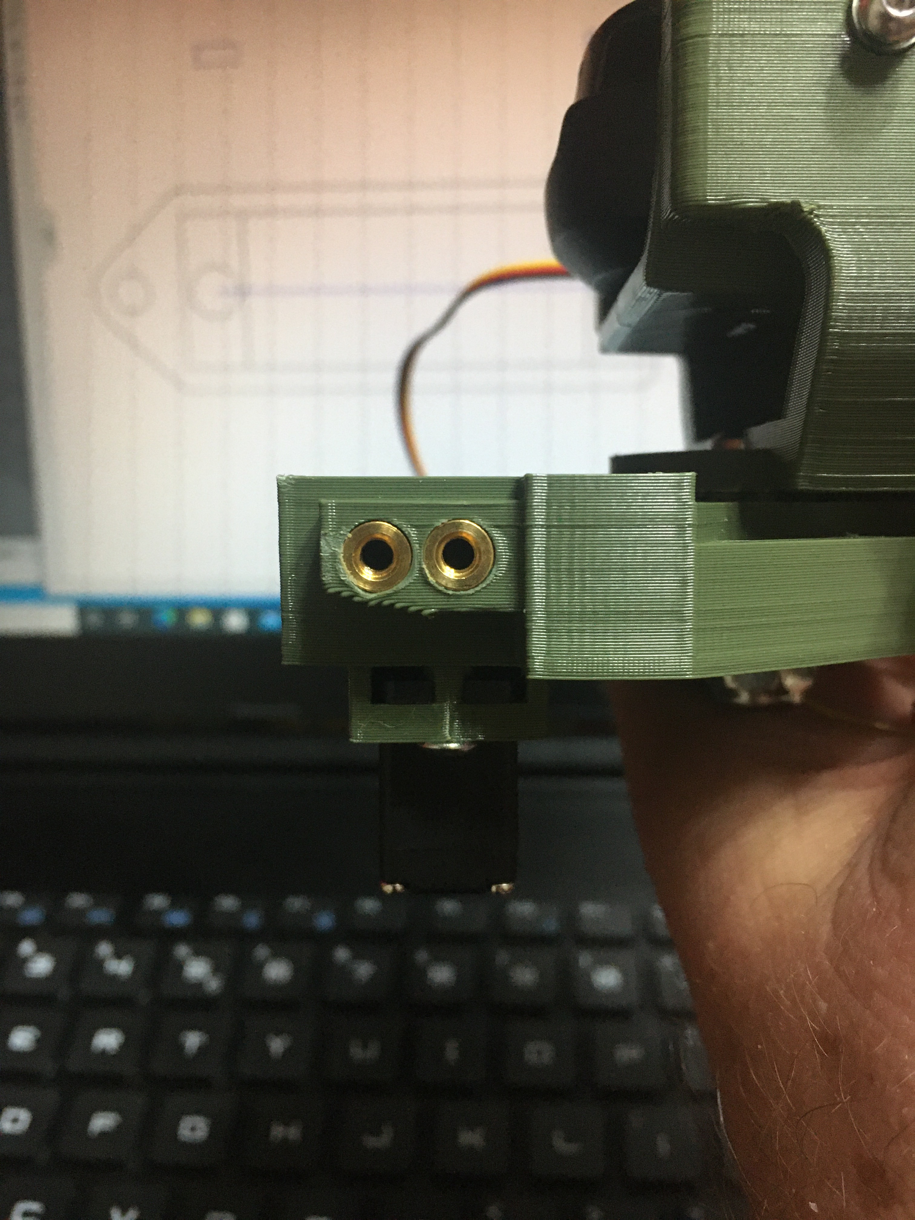

It is a lipo battery alarm, it’s a digital readout of how much charge you have left. You can make sure the charge is good before putting it somewhere you cannot get it from.
Welcome to our forum, Davis…Enjoy! :smile:
That’s cool, I was suspicious of it working with the battery. Very cool and good idea.
Looks pretty slick. The gray is a nice touch.
