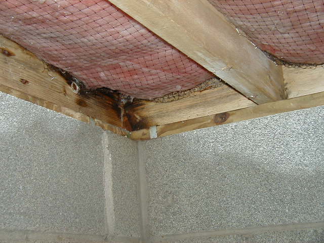

Crawlspace ventilation problem in the corners (classic)

Originally Posted By: gbeaumont
Hi Jeff,
Nice shot, is there any ventilation in this crawl space, and if so how many openings and how far from the corners ??
Regards
Gerry

Originally Posted By: ecrofutt
Just a thought.
I've seen this before when the cause was a leak in the vinyl trim corner above. The top of the trim piece was exposed to allow water to run down inside the trim.

Originally Posted By: jremas
It is more than a ventilation problem. This problem is on all four corners. There are 4 vents on the 4 corners that are 8" x 16". The additional problem is that there are no gutters on the property.
