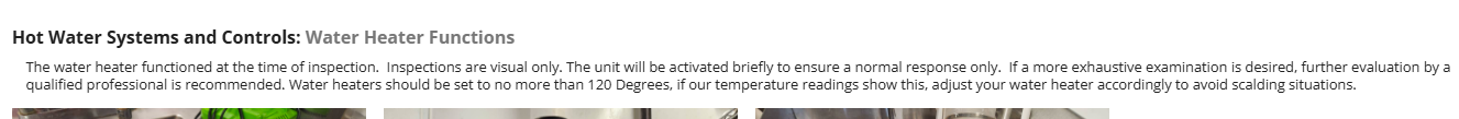

Crazy find on a recent maintenance inspection
Check it out!
Might wanna check those canned narratives. Crazy find indeed.
A little tip for the OP, since it seems like he might be using the same template for commercial as he does for homes. Once you are done with the report but before you send it, save it as a PDF and then search the PDF for the words; home, house, residential, etc. Then go back and edit those narratives or other areas where these words show up. It will make for a much more professional presentation to a commercial property client. I searched the PDF of your report and found the word “home” used 16 times.
Since I use the same template for residential and commercial, I try to write my narratives to be universal. But the above method has caught a straggler several times.

Someone should proofread reports before they go to clients. There are many errors on this report.

I read some very troublesome observation narratives in several sections and returned to the post after 5 minutes. Very inaccurate statements. This type of reporting would get someone in a bunch of trouble IMO.
