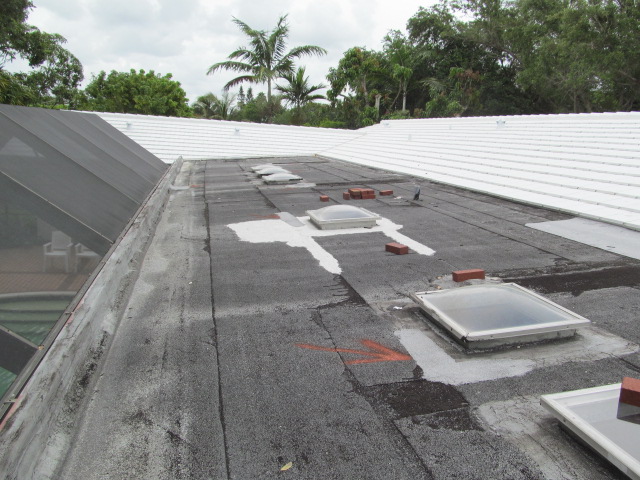

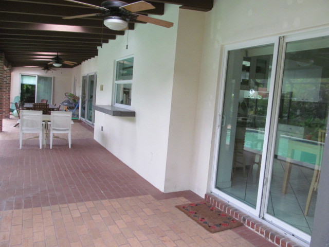

One of my clients had class A removed after a reinspection performed by an adjuster for *******. They removed class-a, because of the skylights over the porch, (The porch is open air and does not breach the envelope). I thought this was retarded and just wanted to share. The reinspection did not mention the skylight location, just that they were not impact rated.

LMAO…the screen doors to the lanai are do not impact rated covers neither! What a freakin joke…

Have a question also. If the skylights are installed over the lanai and the lanai has heavy duty electric rolldown shutters does that now make the skylights part of the envelope? I did this a while back and may not have been correct. But I had plenty of pictures so I am sure the insurance co figured it out.
That is a good question. If that was the case where the protection would enclose the skylights to the unprotected side, then the skylights should be rated also.
Thats not the case in this example. this example is showing the reinspector removing the class a discount for no reason.
Then there is uncovered openings, unless the skylights are impact rated.
