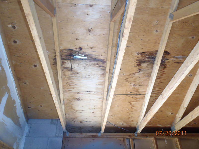

While walking on the roof of a home yesterday there was an area that had a crunchy sound and feel to it. I actually found several areas like this.
I then went down to the garage below to take a look:
The roof was fairly new and appeared to have a piece of sheet metal covering the hole.
The buyers dad is a roofing contractor, she will have him busy!
I’m lucky I didn’t go thru.

For some unknown reason, it appears to be standard practice to just cover the rotted wood instead of replacing it during a re-roof. I see that quite often.
For anyone going on roof’s.
Get in the habit of looking or inspecting underside of roof first before you actually are on exterior. Just good safe practice.

In FL, roofers are required to replace that damaged sheathing when re-roofing. That roof looks fairly new. I would refer that back to the roofer.

Standard practice with the fly by nighters.
And yes it’s code in FL to replace the rotted wood but it only happens when the home owner is watching.
Definately a call out. Some one didn’t have the lumber/time/money and thought they could get away with it.
