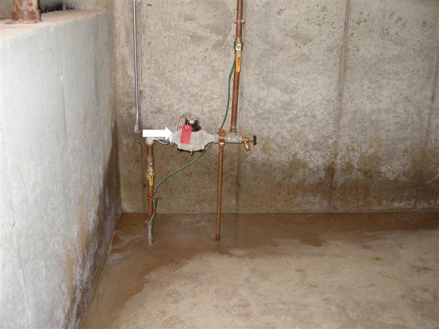

On June 11, 2008, I performed an inspection of the above captioned property. The inspection was limited to the concrete foundation walls, concrete floor, and exterior site. The purpose of the inspection was to substantiate the concerns of the client regarding moisture in the basement.
BACKGROUND:
The client provided the following information regarding the construction of the subject property:
-Walls poured early April 2008.
-House built and “in the dry”, basement floor placed first week of May.
-Finish grade June 1.
-Persistent dampness and even liquid water has been present since floor was poured.
-Neighboring homes present basements that are substantially dry in comparison.
CONDITIONS:
The foundation walls are poured concrete with typical brick embossing on interior and exterior above grade. Form ties have been removed. Floor is concrete, steel trowel finish. A sump pump exists and appears to be serving exterior footer drains. No interior drains are apparent.

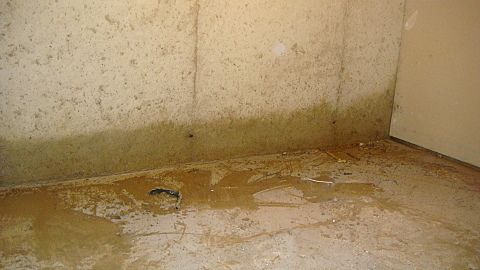

All walls and the perimeter floor are considerably damp. Many areas are wet with liquid water. Efflorescence is forming and is an indication that the dampness is continuous or cyclical.
The exterior is graded and is awaiting topsoil and seeding. Many voids along the exterior foundation backfill reveal what appears to be spray applied damp proofing. It should be noted that damp proofing is not the same as waterproofing according to ICC / IRC.
The interior humidity within the basement measured 68% @ 67 Degrees.

The conditions that may lead to excess interior moisture are many, but are likely to be:
-Latent moisture evaporating slowly from poured concrete.
-Condensation formed as moisture-rich air encounters the cool foundation walls.
-Ground water is entering through the foundation walls due to inadequate damp proofing or water proofing.
- Ground water is entering through the floor or at the floor / wall intersection do to inadequate sub-slab water control or omitted vapor barrier.
