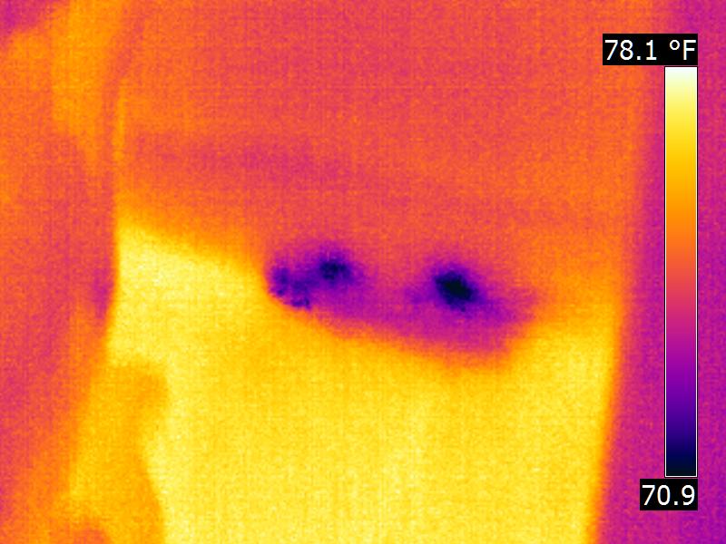

Here are two leaks I caught last year when I first started using my FLIR EX320 (that to answer Bob’s questions about what cam we use).
The AC was broken, so did not have much temp. differential inside.
The first image was taken from the bedroom, had a bathtub on the other side of the wall. No access to plumbing (as is very common).
The 2nd image was in between the toilet and lavatory. On the other side of the wall was the 2nd bathroom with bathtub also leaking with no access to the plumbing.

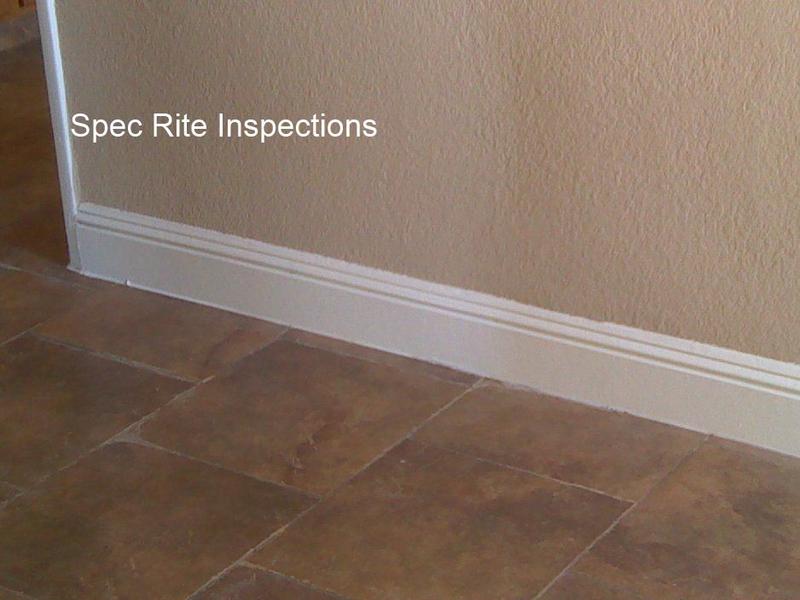

Everyday… something. Was scanning, thought I saw something… bingo! Wall wet about 4-6" up from top of baseboard and about 24" each side of corner.
Posted Visual and Infrared would you have really caught it with naked eye? No puddle…nothing to catch eye with.

It did not matter if the A/C was working or not, dealing with cold water your delta T is almost automatic even in Texas;-)

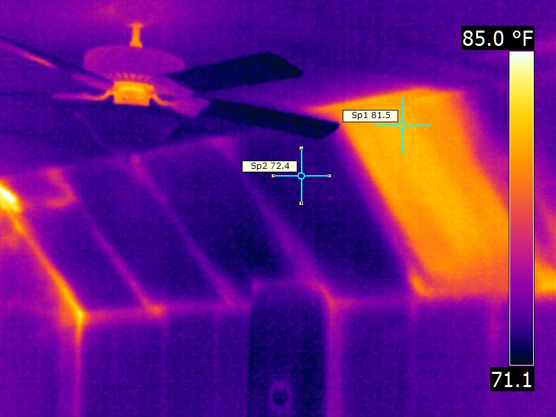

I do lot of phase inspections which include final phases. Every now and then, insulation is removed for XYZ reason and never put back. How the drywall team can close it up without saying anything? I don’t know…
This was a $600K house.

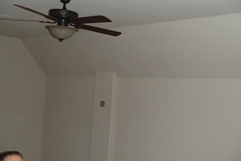

Find it interesting the fan motor housing is less hot than the wire shaft above it.
wmisegades
(William T. Misegades)
November 14, 2013, 4:08am
36
Not less or more hot, just different material with different emissivity .
Perhaps John M. could answer this… :twisted:
