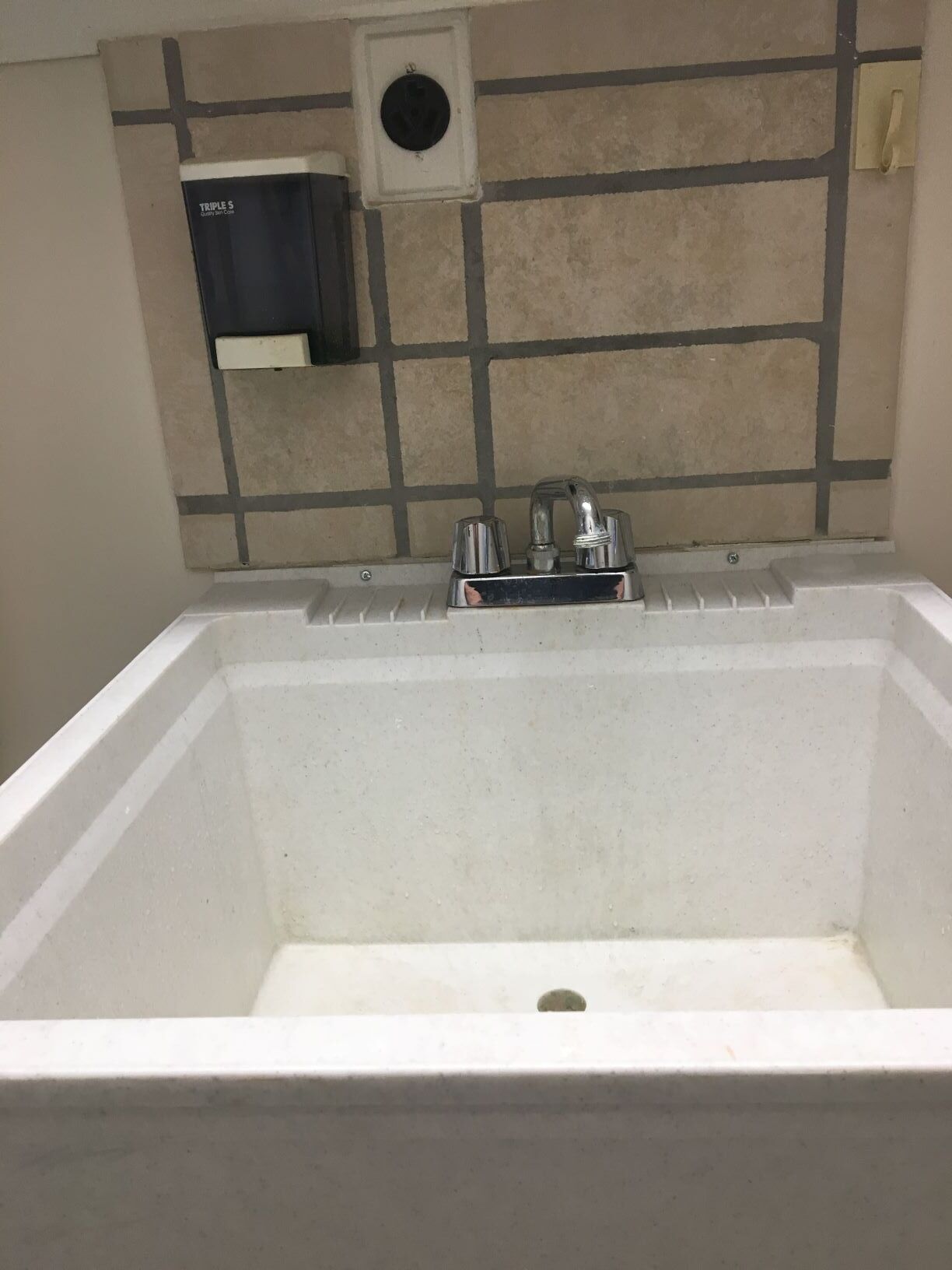

(John Holdway, HI11799) #1
Photo from a recent inspection. I still cannot believe the things people do…

(Christopher Currins, CMI) #2
I don’t know of any code that would prohibit that.
(Chuck Evans, CMI TREC 7657) #3
The issue with receptacles near water is not the receptacle itself, but what someone plugs into it. I doubt anyone is going to accidentally drop a clothes dryer into a sink full of water.

(Emmanuel J. Scanlan, TREC# 7593) #4
Did you test it to determine if it was even active?
(Joe Funderburk, CMI) #5
I bet I could find one if I looked hard. That receptacle obviously isn’t approved for wet locations. I would write it up real hard. I agree with the OP that it’s a life safety issue.

(Joe Funderburk, CMI) #6
That doesn’t matter. Flipping a certain breaker or switch could make it active.

(Christopher Currins, CMI) #7
The location of that receptacle is not defined as a “wet location”. If you can find something please let me know. Always willing to learn.

(Jeff Zehnder) #10
Remembe4r that just because the code does not address it…its still a bad idea…
And code standards are similar to being happy your child came home with all “Ds” in school, after they passed!

(Emmanuel J. Scanlan, TREC# 7593) #11
Part of testing would include checking the panel(s) to ensure no assigned OCPD. It is always possible the outlet was abandoned and its OCPD used for a new receptacle outlet location. Of course we were not there and only the OP can tell us if there was another receptacle outlet and whether or not he checked the panel(s) for an assigned OCPD. :wink:

(Joe Funderburk, CMI) #12
I thought that was a bathtub!!! If it’s a sink, which it appears to be on closer examination, I retract everything I said previously.

(Christopher Currins, CMI) #14
Yes, a laundry sink.

(Michael Bitterman, CMI HI7792) #15
Was it GFCI protected? Maybe it was for a big ***** hair dryer.

(Michael Larson, WI Lic. # 1672-106) #16
It’s a 30A dryer outlet.

(Chuck Evans, CMI TREC 7657) #17
What if someone is holding the clothes dryer while standing in the sink full of water and accidentally drops it?
