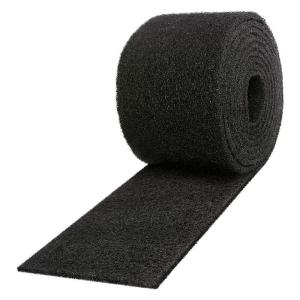

Ridge cap missing proper mesh.
Mesh example image.

For one…That crap will hold moisture and become a mold haven…
It’s the underside of the galvalume ridge cap.
