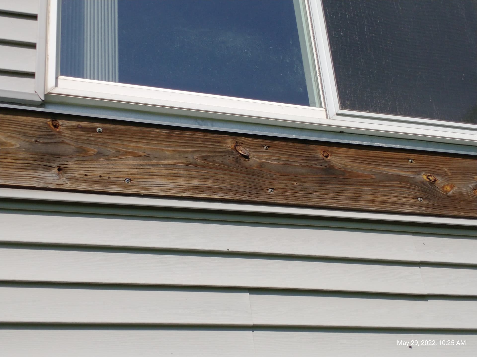

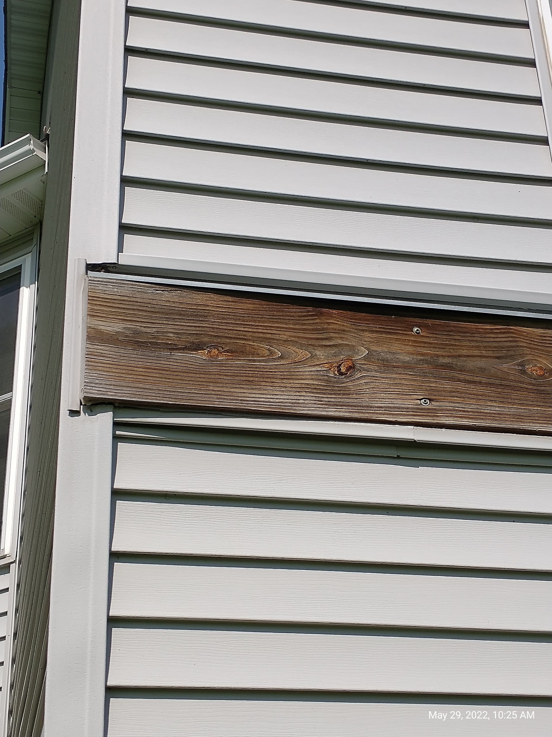

Inspection today with some ledger board issues…

They hacked into the vinyl corner board. Not good.
The lack of fasteners at the end of the ledger board was my biggest concern. The other picture above shows the fasteners not installed in a staggered fashion.
Interesting to comment on a ledger for a future deck that may or may not be installed. Easy enough to do but it falls into a weird category such as a basement stubbed for a bathroom, an expandable electrical panelboard, pre-piped radon system, carport that could be enclosed…you get the idea.
I think it’s best to assume or error on the side of caution in this case for sure.
I would comment on it as well. Not adequate to receive a deck without reinforcement as well as weathered material and susceptible to water intrusion.
