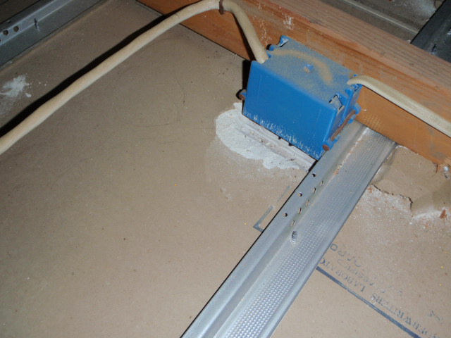

Here’s an example from today. This is how it looks on the other side of the drywall. This is why the “rule” exists for maximum recess of boxes and such.

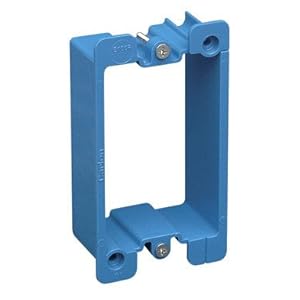

They could have possibly fixed that with one of these:
I write this up all the time. The box was mounted improperly and needs to be mounted properly. There are some covers that have tabs on the tops of them that lets the cover rest in place which makes installing the screws much easier. Unless, the box is 3/4 of an inch away! I found one box that was so recessed, someone used 2 inch screws to mount the cover!

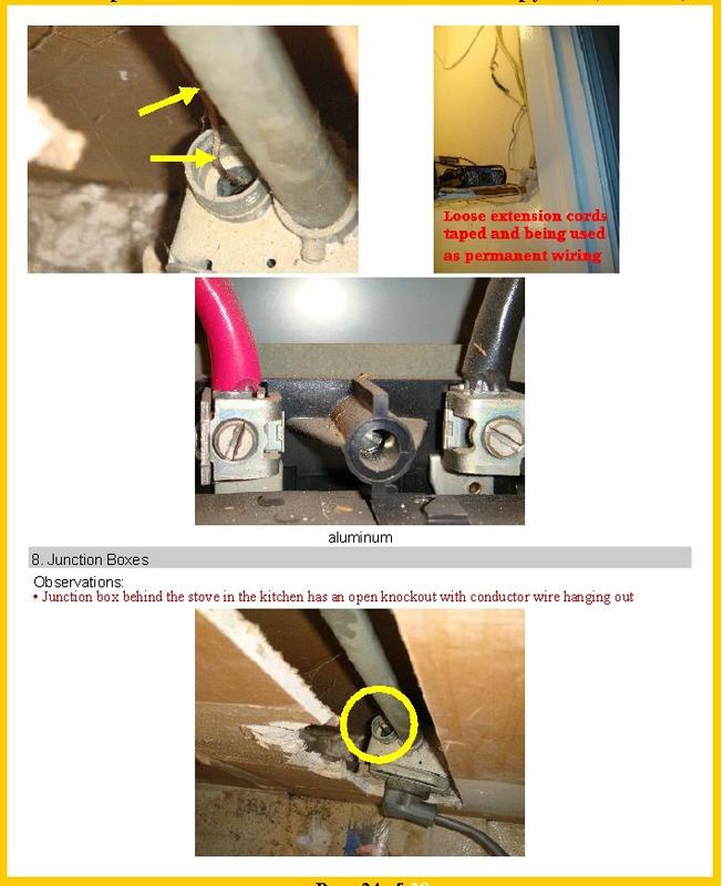

Bob, do you call out aluminum SEC?
There is nothing to “call out” with AL SEC conductors. Stranded AL is not an issue.
The problematic AL was generally 10 AWG or smaller, solid strand, used in residential branch-circuit wiring.
No
But if branch circuits are aluminum I do comment on that.
In Illinois we report all materials used and I often include pictures that are not defects as part of the report.That is simply me documenting feeder conductors as part of the overall report.
You are simply seeing a material comment in the above.
