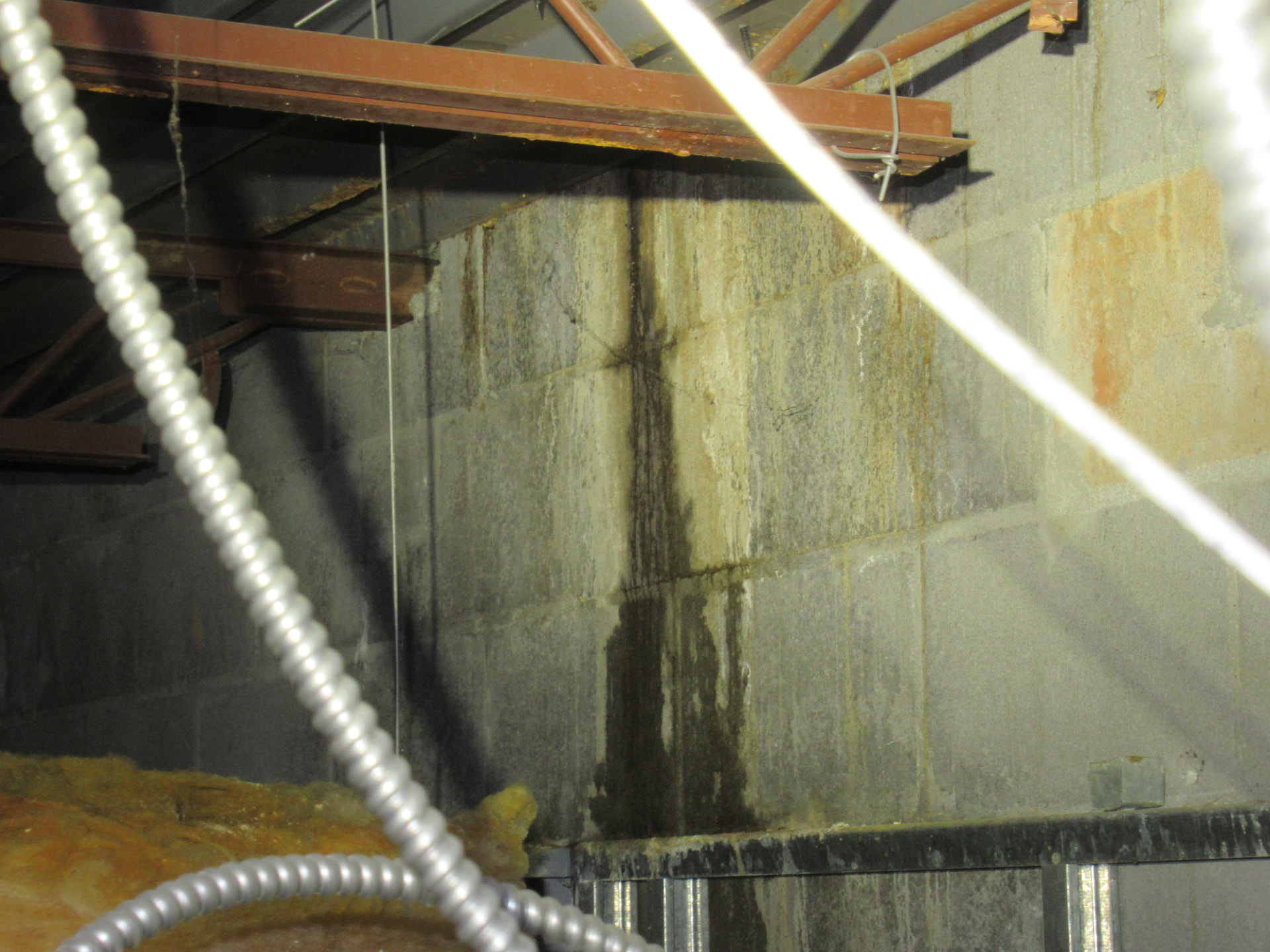

These are from a commercial inspection we did a few days ago. So many issues I was sweating maxing out the 64GB memory card lol! Facility manager said the roof coverings were seal coated a few years ago and no leaks. Hard to say if the auto floor jack with a wood post or the pots and pans above the suspended ceilings overflowing with water was my favorite :thinking: :upside_down_face:

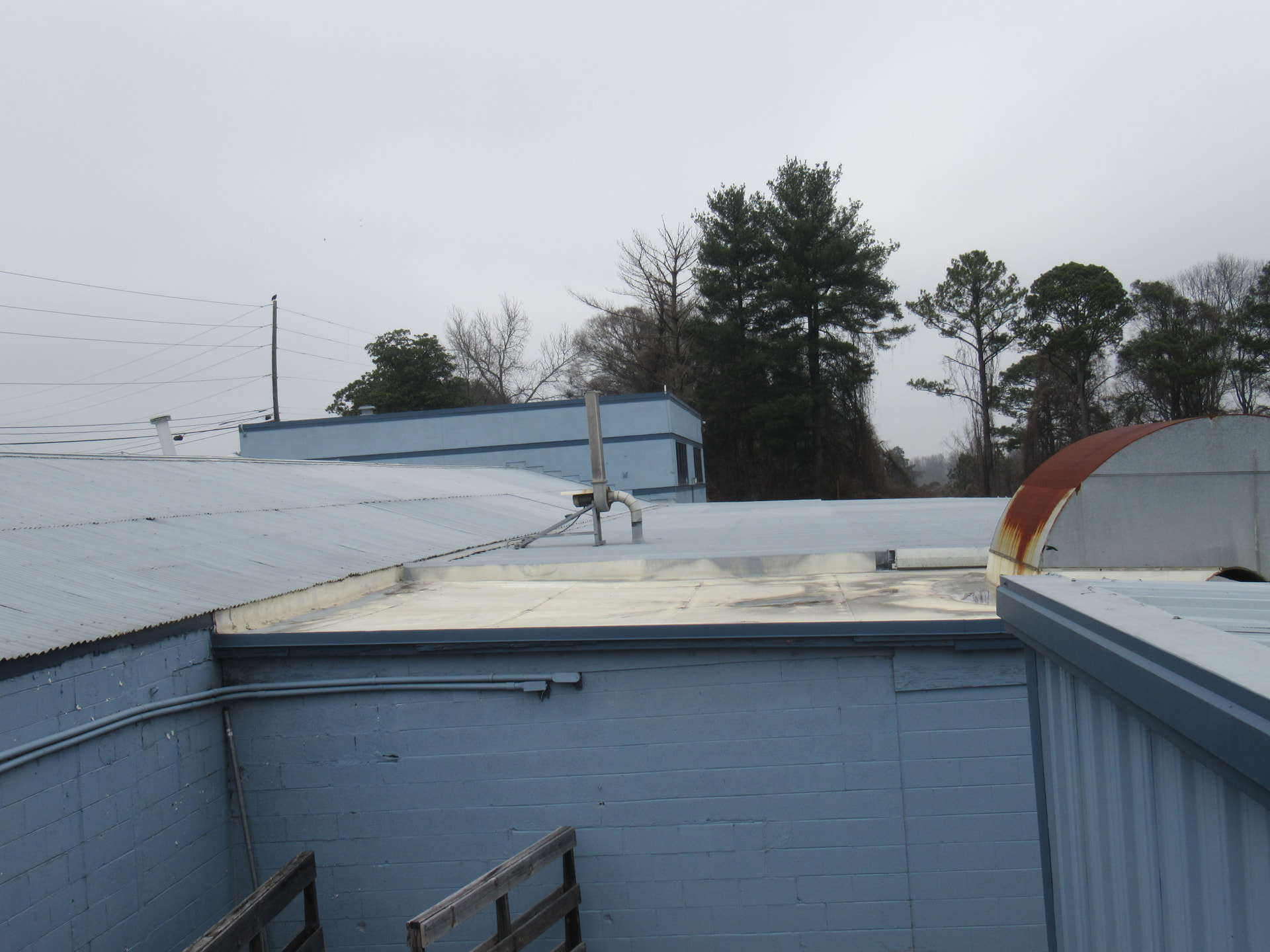

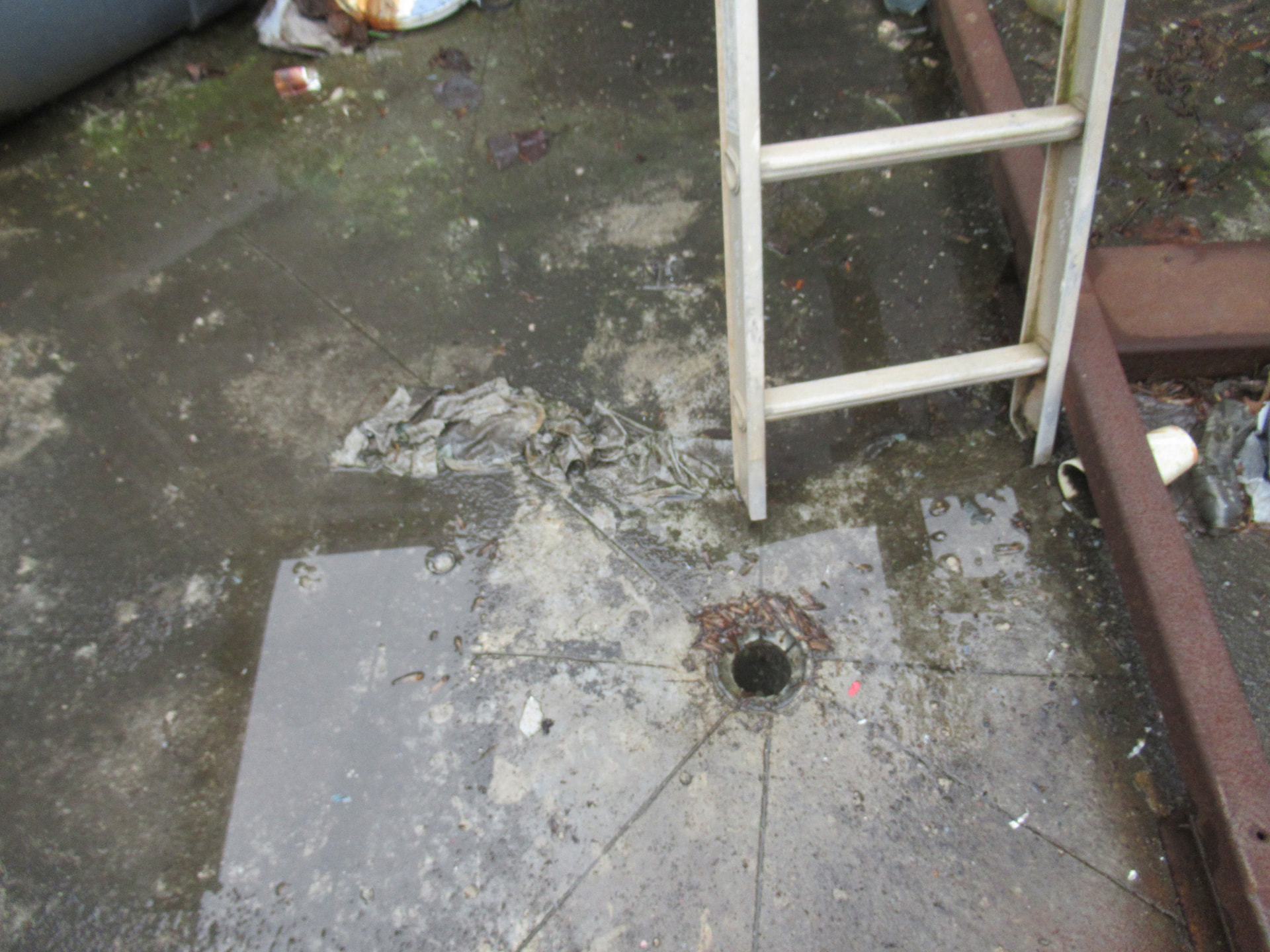

This commercial property we did last Friday. It was a small strip center. The roof covering is a single ply membrane TPO/PVC. There are two tenants with restaurants. Hood exhaust vents were typical upblast type on the rooftop. Often, they are poorly maintained or serviced. Improper, inadequate, or missing grease collectors/filters, etc. Well, overtime that cooking oil, grease, and junk degrades the roof covering material. Tenant for one restaurant said they had a few ongoing roof leaks. When I got on the roof and looked, sure enough the reason you have leaks is because you probably never maintained your hood exhausts.
I often here from PM’s, roof contractors, roof warranty reps even that we don’t care about ponding water, debris, HVAC condensate discharge, grease, etc. Acidic PH water even from pine needles or bird poo puddling over time will degrade PVC/TPO.
