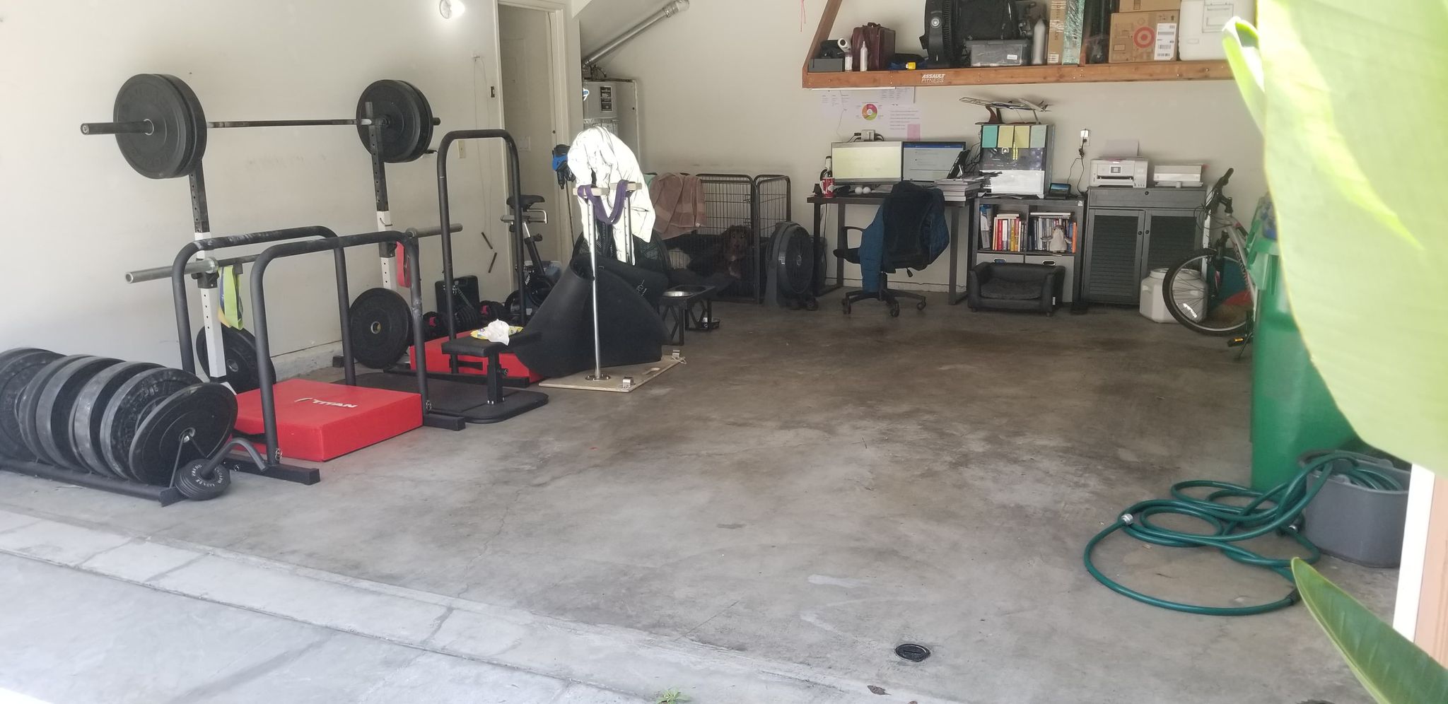

I need help as I am doing my first mock inspection. I am inspecting a condo that we live in, but could not determine the type of foundation that we have. How do you usually determine the type of foundation if there is no access to a crawlspace?

Thank you for responding, here are the details.
3 level Condo unit 2 bed/2.5 bath built 1993 located in Irvine, CA.
I attached pics of the outside and garage.
I did not see any crawlspace entrance.
Considered a slab on grade and build up. Everything is built up from there. Just need to determine framing and support going up from the slab footers, etc. wood frame, support piers (more than likely) concrete, metal…

NO. Like with anything else when writing a home inspection report if you can’t determine what it is say so.
An example in your case would be something like appears to be a slab foundation but I was not able to confirm that.

Stomp on the floor. It will give a little and sound kind of hollow in it is a wood floor/crawlspace and will not give any and feel like you are stomping on a sidewalk (solid), if slab.

Something different. As I am preparing the paper work on a new inspection I always cross reference listing data with state tax information, its public. It is generally very accurate and will tell me just about everything about the house.
Just write it down as unknown don’t guess if you can’t see it don’t describe it gets you into trouble. We inspect what we can see no x-ray vision here.
